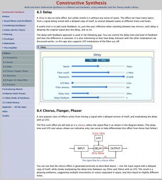

I've always been into teaching and have written a lot of things for learning maths, so given the fun I've had (re)learning synthesis, coding with web audio and building synthesiser tools with Teensy, and also the number of people who want to use the Teensy to do similar things, I thought it might be good to put together something covering what I consider the foundations.
The first draft is here: http://thewessens.net/synthbook/
It's a website including over 30 webapps to allow visual/interactive learning of the important principles, 10 Teensy + Audio Shield projects, and a bit of history. I also discuss & demonstrate patch creation using a simple open source synth kit, Mentor, a 16-voice polyphonic Teensy-based synth, designed for learning subtractive synthesis.
I'd be very happy to hear of any errors or confusions that you might notice, or for any constructive suggestions. I've got several ideas for additions - mostly relating the content to specific synths, but I'm happy for now with the coverage and depth.

Finally, here are some snapshots to give an idea of how things are presented:
