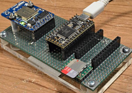

I'm happy to report the SPI transactions are working great.
I modified the CC3000 example to repetitively read a 3000 byte file from the SD card while waiting for the CC3000. Without SPI transactions, it crashes on Teensy 2.0 within just a few iterations. On Teensy 3.1, it and can't ever access the card, because CC3000 doesn't save/restore SPI settings for non-AVR chips. With SPI transactions, it works perfectly.
Here's the code that waits for the CC3000 incoming data, while calling read_sd_card(). I'll attach the full code to this message.

At startup, 3000 bytes of random data are written to a file and kept in memory. The read_sd_card() function reads the file and checks 3000 bytes are the same as originally written. The full code is attached below. (you must edit to add your SSID and Wifi password if secure)

Here's a photo the hardware I used for the test in #11.
