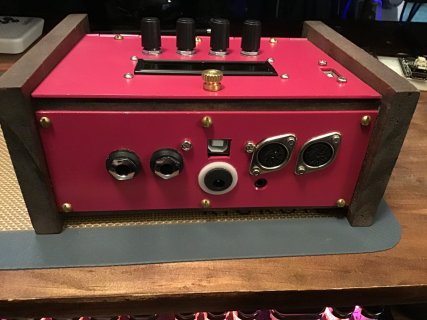

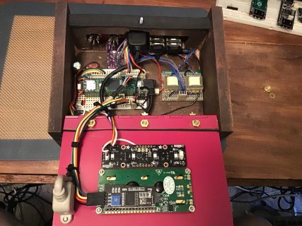

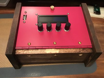

For whatever it's worth, here's the build. Using Adafruit 'seesaw' encoder board, UDA1334 codec, Triad TY-250 transformers ( 20hz-20khz , 2.8db insertion loss )
I have the "alternate" library compiling with zero warnings. My choice was arbitrary. I made the most sane changes my skills allow. Nothing significant, just silencing annoying warnings. Put the device to a torture test for a while, no undesired behavior, even with a fast arpeggio.
You can see these changes on my github *branch*. (KreoPensas)
Warnings may only be warnings, but devices that act possessed are absolutely no fun. Nobody wants those.
