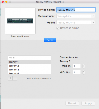

For those interested I've added a way to configure the usbMIDI Port Names, these are changed in the same manner as the Manufacturer Name, Device Name, and Serial Number. So to change the names from the default "Port 1" - "Port 16" you add the following struct to the name.c in your project, one for each port number.
#define MIDI_PORT1_NAME {'T', 'e', 'e', 'n' ,'s' ,'y' ,' ' ,'1'}
#define MIDI_PORT1_NAME_LEN 8
struct usb_string_descriptor_struct usb_string_midi_port1 = {
        2 + MIDI_PORT1_NAME_LEN * 2,
        3,
        MIDI_PORT1_NAME
  • usb_desc.c
  • usb_names.h

I’m trying specify custom port names with Teensyduino 1.53, Teensy 4, and macOS Catalina.
Serial + MIDIx16
Product name, Manufacturer, and Serial are not a problem. I increment the serial number to load a fresh build.
Not sure where I’m going wrong and could use some help.
Here’s my name.c :

Is there a way to "bypass" Port Name in single port mode (MIDI or Serial + MIDI) ?
I am not aware of any way, at least from code running on Teensy. I did try this by editing descriptors. For Serial it is possible to affect the name shown on MacOS and Linux, but not Windows (because it ignores the descriptor name and gets the name from an INF inside Windows). For MIDI, as far as I know the descriptors can only affect the name of the whole interface. If there is a way for the descriptors to give names to the individual cables/ports within the MIDI interface, I was not able to find it.
On Windows, this sort of thing can (probably) be done by crafting a special INF file which you install into Windows. But that is a pretty unpleasant path. On top of the pain of figuring out Microsoft's horrible INF format, all modern versions of Windows require a CAT file with digital signature to install any INF. Recently the process of obtaining a code signing cert has become more difficult, requiring either the one-time cost and complexity of a hardware token or the use of a cloud service with ongoing monthly cost. At least the good news is you only need an OV type cert. EV is only needed if your install includes actual executable kernel-mode code. For just an INF you only need OV type signing. Even once you get a properly signed INF+CAT, the process of installing a "driver" for Windows usually means giving users a set of error-prone steps to follow or you end up providing an installer program (which you'll be able to sign with same code signing cert).
Hi Paul,
Maybe I didn't explain my problem very clearly because I'm not sure to understand your answer...
Let me try again :
Firstly, lets assume I only work on Mac to narrow the answer...
Several years ago, when I uploaded code to my Teensy 3.2 in Midi mode, it used to be visible as "Teensy USB" (or any other name I configured in name.c file). Now, when I upload the same code to the same Teensy, it shows as "Teensy USB Port 1". I suppose it is due to some refactoring for MIDIx4 and MIDIx16 modes that need a name for each port...
Here is my question :
In MIDI or Serial+MIDI modes, is there a way to display only the name "Teensy USB" (or any other name I configured in name.c file), like it was in previous version of Teensyduino, instead of "Teensy USB Port 1" ?
Regards,
Answer to myself : if I set an empty port name in the "name.c" file, it works.
I already tried this before but I can see the change only if I restart the program I use to receive MIDI.
Here is the code if someone needs it :
C:
#define MIDI_PORT1_NAME {}
#define MIDI_PORT1_NAME_LEN 0
        3,
        MIDI_PORT1_NAME
