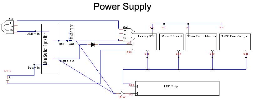

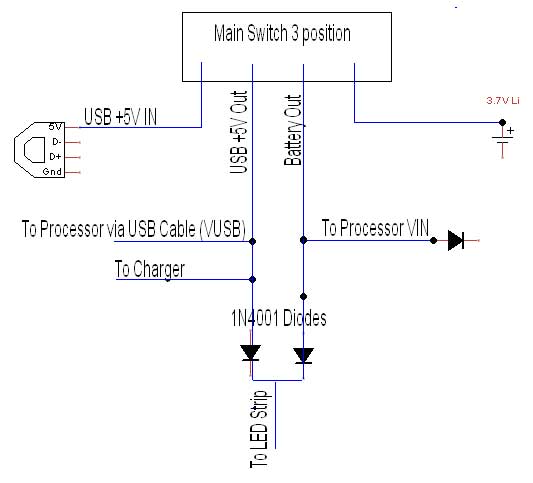

I am planning on running the Teensy from an external power supply but I also want to, when needed, be able to run from the usb in.
When I first bought the teensy and told Paul what I wanted to do he said:
So, today I put the teensy into the breadboard and ran some LEDs from it for the first time. I first ran it from the usb. Once I had my test sketch in place I wanted to test it from the battery so I went ahead and cut apart the pads between VIN and VUSB (or at least I think I did). I am putting up an image to show the trace I cut between the 2 pads.
After I did that, I tested it on the meter to make sure the pads were cut then I put it back in the breadboard, hooked up external power and everything seemed to work ok. The strip ran from the test sketch I had uploaded.
But then I plugged the usb back in and disconnected the external power and had nothing. I had no power at the processor and therefore, of course, could not upload any changes to the sketch or anything like that.
So, I then resoldered the pads together and plugged the usb in and could once again talk to the processor and power the test strip. I then connected up external power and after it was connected, unplugged the usb and everything kept running fine. I then replugged in the usb and again everything kept running and then unplugged external and everything kept running. This seems to be what I wanted and from what Paul had said what I assumed I would get with the pads disconnected.
So, what did I do wrong?
Thanks in advance for any insight or advice. It is all very much appreciated.

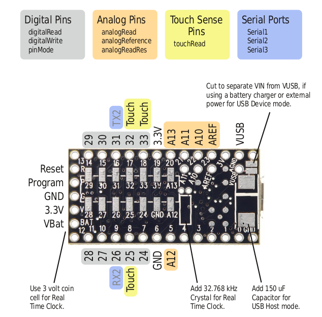

![teensycut.jpg](/proxy.php?image=http%3A%2F%2Fwww.madspiders.com%2Fhoop%2Fteensycut.jpg&hash=36af620caa6536f318fe813f5832d544)
![pinout5b.png](/proxy.php?image=http%3A%2F%2Fpjrc.com%2Fteensy%2Fpinout5b.png&hash=5ada5757d863d1f42a1917bf896453a2)
