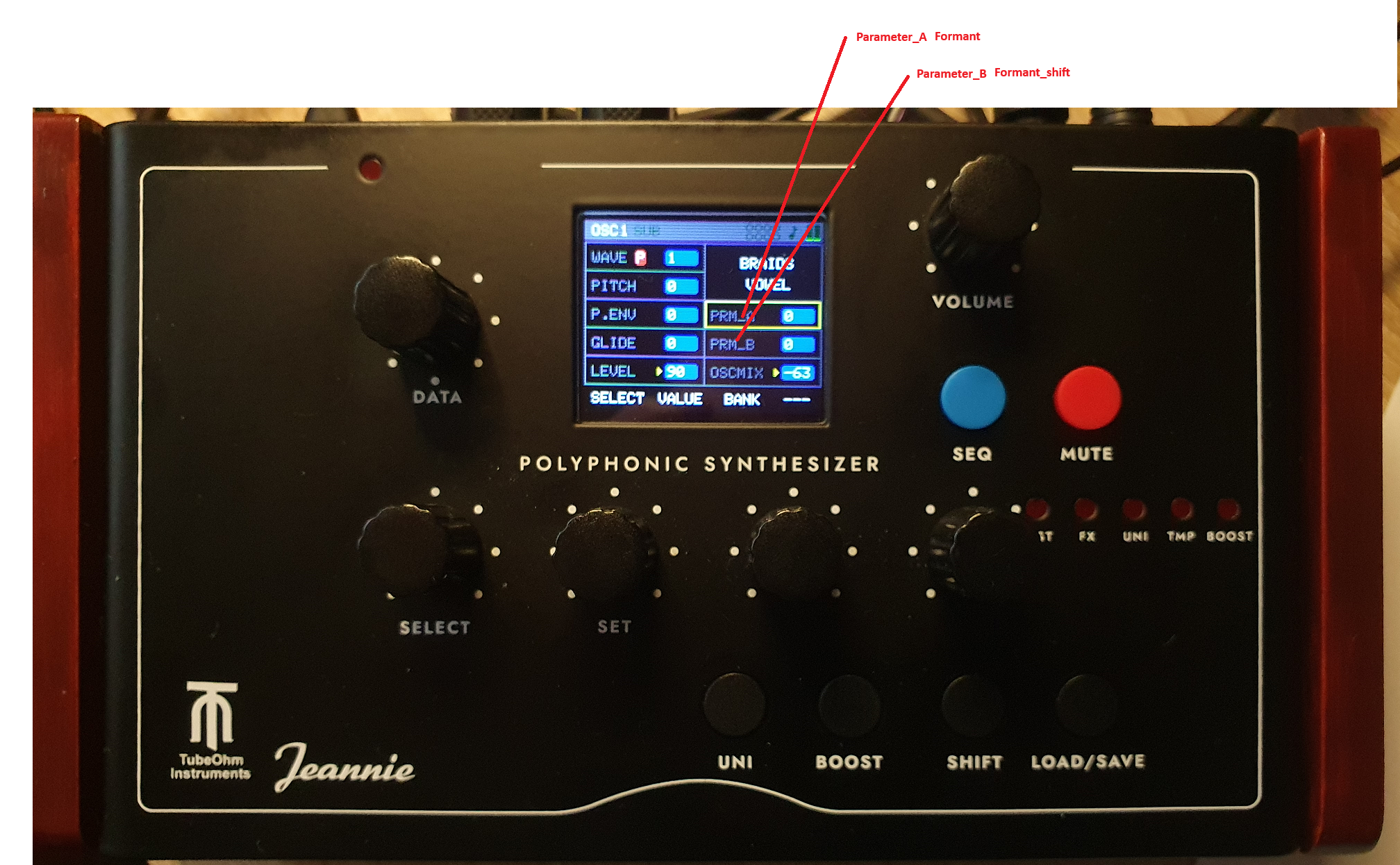

Hallo Teensy Friends..
I added two new inputs for modulation parameters (par_A /par_b) into the oscillator code (AudioSynthWaveformModulated). When connecting to audio mixers, the system crashes when starting. Unfortunately, there are no exact instructions on how to integrate two new inputs into the oscillator.

My complete code on github https://github.com/rolfdegen/Jeannie-Open-source-Synthesizer/tree/main/Jeannie 2.74/src
Thanks a lot for help :) Rolf

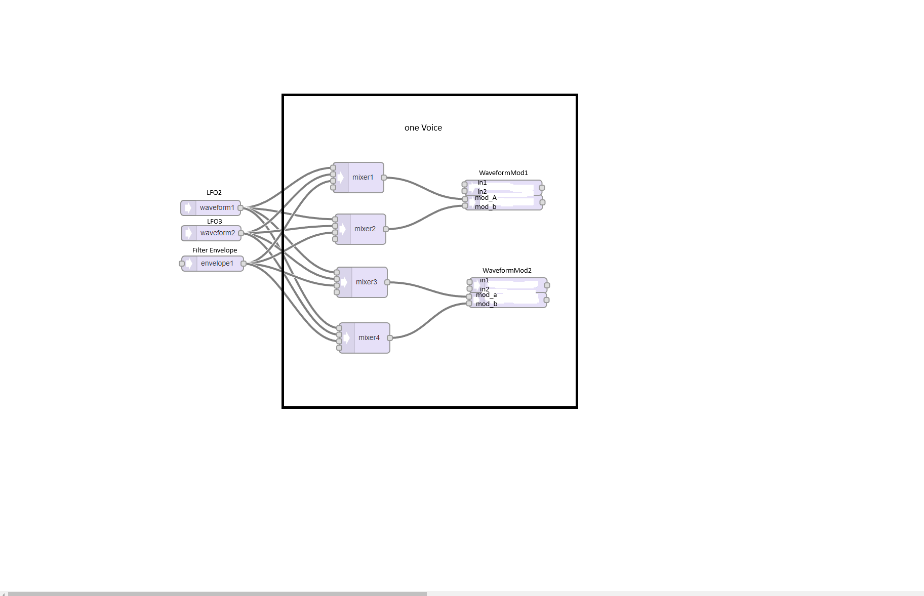

Could it be that I have too many AudioConnections? I added 32 mixers for the oscillator modulation (4x per voice). Then the problems started.

Modulation shematic
The important thing from the CrashReport is
Check code at 0x15F60 - very likely a bug!
Run "addr2line -e mysketch.ino.elf 0x15F60" for filename & line number.
Search the forums, there's a fair amount of info on how to run addr2line to show the exact line where your code is failing - of course, it could easily be in library code you didn't write, so you'll be pretty dependent on figuring out what it's doing!
One thing I spotted on a read-through of AudioSynthWaveformModulatedTS::update() is that you're not checking for null pointers coming back from receiveReadOnly(). There are two reasons for getting null: one is no connection, or the source object isn't transmitting data, in which case you MUST interpret that as a block of silence. The other is there are no audio blocks left, which I suspect is the case: down around lines 308-313 you have the "no modulation input case", and you don't release moddata, par_A and par_B, so they'll remain in use and you'll exhaust the audio blocks very rapidly. Then you'll get null block addresses from receiveReadOnly() ... which you don't check ... and you access the (non-existent) block pointed to ... which likely causes "(MMARVALID) Accessed Address: 0x2 (nullptr)".
I'm a big fan of avoiding multiple return points and multiple places where you allocate and release memory, for this exact reason - you can end up with one path through a long function which doesn't do the necessary balancing release(). You should do your releases around what's currently line 315, and don't release a pointer if it's null (that should be a no-operation, but the stock audio library doesn't check...).
Thank you for the good tips. I want to check it. Is my code for additional inputs in the oscillator correct in principle :confused: I looked for examples in the audio lib but didn't find anything!
@Rolfdegen: I can't be of much help on whether your multiple modulation input approach is correct in principle or not. However, if what you want is to be able to apply multiple modulation sources to a waveform generator, why not feed those inputs into a mixer & use the mixer output to drive the one existing modulation input on the standard AudioSynthWaveformModulated object ?? That even gives you the ability to adjust the individual modulation input levels if/as needed. Sorry in advance if I misunderstood your intent !!
Mark J Culross
KD5RXT
You seem to have added the extra receive pointers in inputQueueArray[], told the AudioStream base class about them, and to be at least intending to receive and release them correctly, so there's nothing there which is obviously "incorrect" or counter to the normal things expected by the Audio library.
As noted by kd5rxt-mark, it's then pretty much up to you what use you make of the data, and whether it gives you more than you could achieve by mixing into the existing modulation inputs. I had another quick glance at the code, and it looks as if you're only using one of the samples from the incoming blocks, but if that works for your purposes that's fine! Your ears, and possibly an oscilloscope, will tell you if you're achieving your goals.
The Audio library is definitely a good place to look for inspiration, though the code quality is a bit variable - I've found and fixed quite a few bugs, and I'm sure there are more to be uncovered. A lot of it is coming up for 10 years old, and there are outstanding pull requests going back 9 years, so there will be elements that don't really relate to an overclocked Teensy 4.x in 2023. Also, a lot of the code has been tuned for maximum speed, which can make it very hard to read.
problem solved! :D
It was querying null values for the new parameters par_A and par_B. I had a mixer input connected to an envelope and the mixer output connected to the new modulation input. Since the envelope did not provide any data when starting the system, the system crashed.
Thank you for your great help :eek:
Mark J Culross
KD5RXT
In my Teensy Project I use special oscillators, for example a Vowel oscillator from Mutable instruments. These have two more parameters for formant setting and formant_shift. I want to modulate the parameters with LFOs and envelopes
Look my Video. Its a poliphonic Teensy 4.1 DIY Synthesizer.
More information in my Synth DIY blog: https://www.sequencer.de/synthesizer/threads/jeannie-polyphonic-diy-synthesizer.160564/
