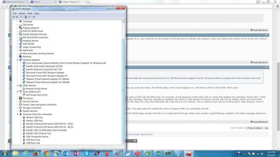

As far as the "HID device with ID 16C0:0478." goes, I am not seeing this device when I connect our board, if you look at the screen cap below this is our device manager with the custom board it does not show the HID device you have described:

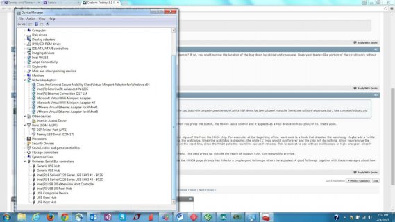

When a factory teensy is attached I get the following device tree, which does show the teensy serial port under the COM ports:

Teensy Loader only responds to HID 16C0:0478. If you're seeing Teensy Loader recognize it, then it must be appearing with that ID.
If Teensy Loader is in auto mode, which is the default when Arduino give it a new file, it'll immediately reboot after programming, so Teensy only appears to your PC with that ID for a brief time during the upload process.
This page explains the native USB and COM port issues. Scroll down to "No Serial Port While Programming".
http://www.pjrc.com/teensy/troubleshoot.html
The key point is Teensy only becomes a COM port because the code you programmed onto the MK20 implements USB serial.
