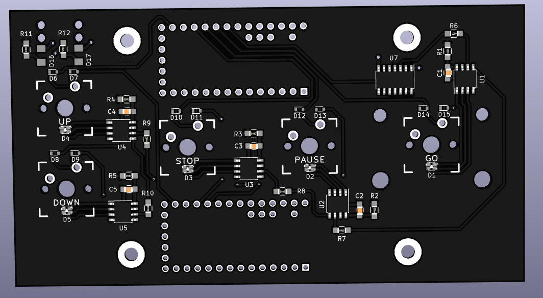

I'd like some feedback if possible on a project that will need to appear to a computer as a USB MIDI device. At the moment I've prototyped this using a Teensy 3.2 which works wonderfully. I want to move the whole design to a custom PCB which is fine - I've done them before. However I'm not entirely sure of the feasibility of this or whether there is an easier way?
Essentially there will be 5 push buttons that trigger MIDI commands and 5 WS2812B LEDs relating to the buttons. That is it.
1) Is it possible to do a custom layout with a 2-layer board? Bearing in mind the board will be 10cm x 6cm, so there is plenty of room on it.
2) From what I have read so far, it seems like you can't just take the components from the current design and put them in a new layout for a custom PCB?
3) Can anyone point me toward any datasheets that I should get reading? I think I need in particular a datasheet for the bootloader chip and CPU probably?

The reason behind the two separate connections to two computers is failover. The buttons trigger a program via MIDI control, and this program needs to be triggered on both PCs at the same time (or as close as possible). If one PC goes down, the second one still needs to be functional. Therefore it isn't possible to do a computer-computer link to share MIDI.
From research I've done regarding using an FTDI chip, the latency (16ms) introduced seems to be a problem. You can seem to reduce that down to 1ms, but I'm not entirely sure whether it'll be work. It might be something I try to prototype and look into.

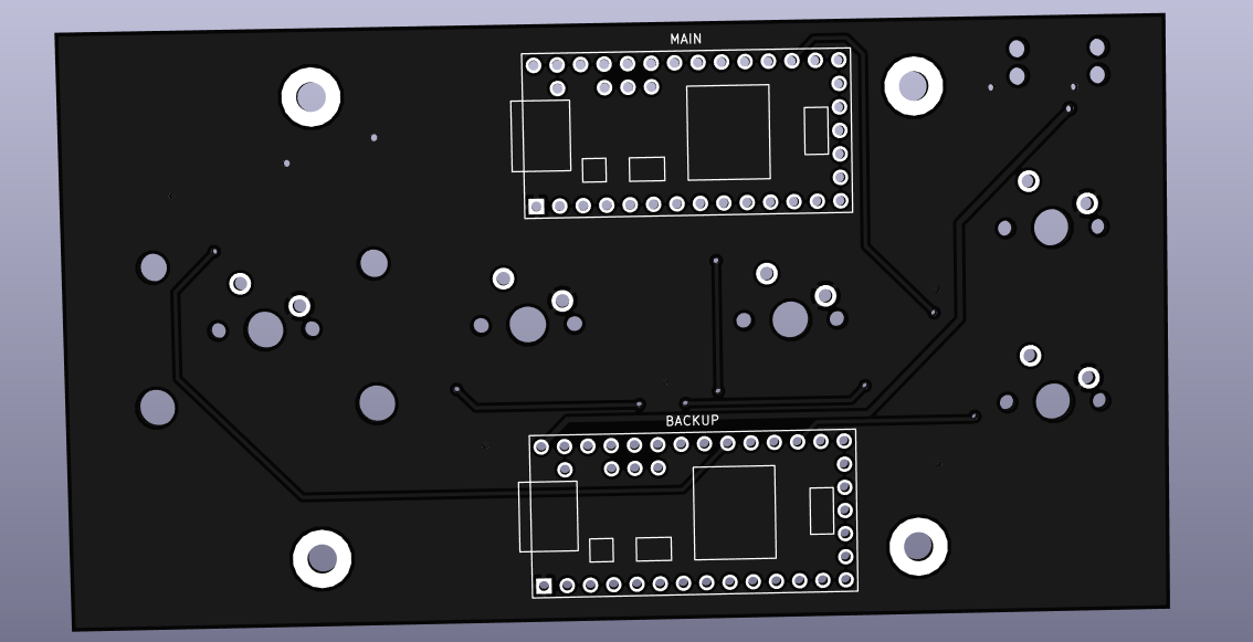

The first prototype I did had two Teensyies attached to the PCB. The grounds were tied together and the buttons connected to the individual Teensyies via Schottky diodes. It all worked perfectly, and as you suggest Constantin, the bugs have been shaken out (e.g. I'm going to add electrical debouncing). This is what I have:
Given the board size, I want to try get a custom (or two) Teensy on to it as there should be plenty of space. What I want to avoid is height (i.e. having to stack a Teensy onto the PCB with header pins etc...)
So presumably my only option is to have it as I have done my prototype, and have all the buttons connected to two Teensys, via Schottky diodes, which in turn connect to two separate computers?
Yes, that is the best way to get the failover capability you want.
You should probably use 2 diodes to combine their power, so the Teensy gets power when either USB is working, but neither can feed power back into the other.

Hypothetically, with a shared ground, if the USB power on one of the computers had 100V on the V+ and 95V on the ground, I'd run into problems? Is there a way to combat that without optoisolating between the two different supplies?
Can confirm it's a problem since I had to buy a new TV. Was a 5V wall wart powered Raspberry Pi that (among other things) monitoring TV on/off state via it's USB power - TV was properly grounded, the phone charger wasn't so the two '-ve' were far enough apart for smoke. Quick check now got 10V AC between my desktop PC USB port and the USB charge port built into the adjacent power strip which is daft since the power strip has an earthed internal chasis.
In most cases Just getting reasonably solid ground wire between the units before power up (and making sure it's not switched through the off switch) will get them to the same potential and things will work, maybe with one not running quite as efficiently as it should because it's 'negative' is feeding power to the gnd but normally talking mA or less. Problems arise if a power supply is poorly designed or otherwise leaky and if you blow one of them up then you probably needed to replace it anyway.
Simple check is to put meter between the two BEFORE plugging them together and seeing what you get (both DC and AC)
If this was my project, I'd opto-isolate due to the damage potential. Why risk a expensive computer or two in case something goes sideways between their power supplies as described above?
If timing is critical, opto the outputs from the buttons themselves and run the same program, completely independently, on both LC's. One of the two Teensy's (presumably the master) would power the DAQ portion, including the VCC of the optos.
LTV-844 has worked great for me and is AC tolerant. I've used it on the input side (isolating an HVAC system AC signal) as well as on the output side (using it to control the fan speed of my humidifier). DIP form factor makes smoke-inducing mistakes easy to remedy.
If you move the teensy's to the edge then mounting them via reflow paste directly to the underlying PCB becomes possible while retaining use of the USB connector. Obviously not a concern should you do DIY.
