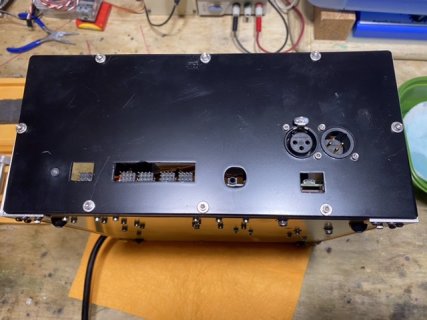

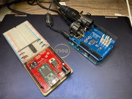

TeensyDMX Lib & existing shield
I’m looking at TeensyDMX and it looks well used/supported so I’m going to concentrate on making that library work.
I’ll start with the mystery DMX shield and move on with known hardware solutions if any are suggested.

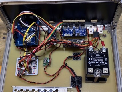

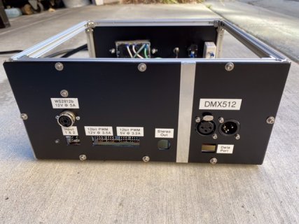

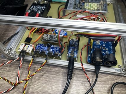

Thanks Paul! The key seems to be the TeensyDMX library. I able to get the library to work the hardware. To my DMX instruments to work just required a change from hex to decimal in the “data” string. Thanks again for the referral.
Jeff
Thanks Shawn!
Do let me know how the library works for you. I’m very interested in making sure it works well and robustly. (I’m assuming you mean this one: https://github.com/ssilverman/TeensyDMX. It’s also accessible via PlatformIO and the Arduino IDE.)

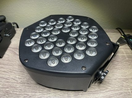

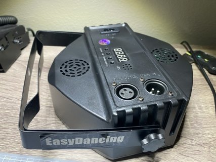

I’m glad you got it working! Thanks for sharing the picture. Now I’m curious, what do you think is different or special about those fixtures? I wonder why my library works and not the others? I love this stuff…
I believe the other libraries made calls to hardware timers that don’t exist on the Teensy (just conjecture). The fixtures have a provision to set the DMX ID but the values either don’t stick or work. I’m waiting for more instruction from the maker.

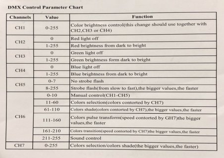

Here are some photos of the fixture and the DMX instructions that came with it. I included photos of the project so far and am I’m going to start on the DMX code later today. I will share code as I move along.
Thanks for being interested, I love this stuff too!
Jeff

How to address individual instruments?
I'm able to send seven channels of information to the first instrument (ID 1) but not to any others. Perhaps this question is too basic for the TeensyDMX documentation; I am a complete DMX newbie. How does one send a dmxTx.set command to other IDs?
If I set the ID on all instruments to "ID 1" then all lights respond to TeensyDMX commands sent to ID 1 (default ID?).
I have four instruments (non-moving RGB LED lights) in total, each capable of receiving seven channels of data.
Thanks in advance.
Jeff

shawn,
Re:
#1 - burp, how funny that I set that here for debugging.
#2 - Thanks for that... I understand the universe now! I reason now that the ID is for different universes. I should therefore set all instruments to ID1 (Universe 0).
#3 - The second possibliity you suggested seems to be correct.
#4 - Hardware (shown in pic on second post in thread) is poorly documented. Pin #2 is set HIGH to enable transmitting as I am reasoning at this point. I really dont know for sure.
#5 - I just found this on the web; it pretty much spells out what I reason you're about to tell me. Still a mystery until I start trying out code but I think I get it; I have to send four sets of seven channels to my four instruments (that all live in the same universe).

Data
1 [0]brightness 0-255
2 [1]red 0-255
3 (2]green 0-255
4 [3]blue 0-255
5 [4]strobe 0-255
6 [5]mode
0-10 Manual control CH1-CH5
11-60 Color Selection (controlled by CH7)
61-110 Color Shade (controlled bt CH7)
111-160 Color Pulse Transform (speed controlled by CH7)
161-210 Color Transform (speed controlled by CH7)
211-255 Sound Control
7 [6]modifier 0-255
