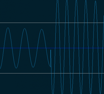

Hi, i have a problem on my teensy audio board.
if I play a note of drum1.noteOn() and i repeat "drum1.noteOn()" before that the length of the first note is finished there is a audio clicking.
If you play a drum2.noteOn() (second drum synth) over the lenght of durm1 there aren't audio clicking but if i want to play more notes it's impossible without clicking....

the click there is only if the tempo is less then length.
Why? this is a problem for make a drum machine or similar...

I've not studied this scenario but could you delay the new note until the next (to negative ) zero crossing of the initial signal? (Given the new notes seem to start negative!)
Or wait until the new signal matches the direction and magnitude of the old.
Or you can temporarily engage a low pass on the output until the discontinuity would be reliably gone ... a few milliseconds perhaps.

The click could be mitigated with a low-pass filter after the module. Just make sure the cutoff is WELL above any harmonic content of the synth sound.

have you tried? You should be able to find a cut off that does not effect the synth output too much if the waveforms look like the image from above.
My suggestion above -- to delay the new note until the old is at an appropriate zero crossing (or is idle) --- might be something that can be done to the module source. But it will be well outside my abilities for the foreseeable future. Still, I've done similar before with desktop audio software so I know these kinds of solutions work.
While formally it would not preclude aliasing it would not be apparent to a human ear if there is no significant jump in the signal and the slope change isn't too pronounced at the join.

The filter isn't a solution, the clicking is very strong and it's always present!
I'm testing a solution using a gate directly on the mixer object When the MIDI keyboard or sequencer send "noteoff" (mixer goes to 0) and "noteon" (mixer goes to 1), but it's very difficult because it's must to be fast and stable... it's a work around for a concrete problem anyhow.
This is a great limitation for a drum object, the drum is made for a rapid sequence and a clicking over a repetition is the worst way to make a function but we can not speak about that ... :p
So adding a noteOff() routine solves the clicking on repeated triggers.
But then it clicks when noteOff is called.
Feel free to give it a try
