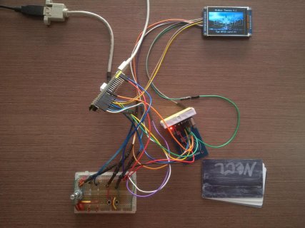

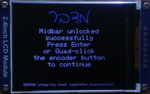

Hello, everyone.
Let me announce that the Midbar (Teensy 4.1 Version) V2.0 is out.
That version of Midbar combines in it the password vault, credit card vault, phone number vault, note vault, data encryptor/decryptor, and data hasher.

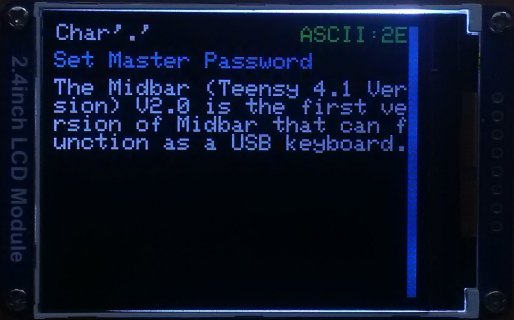

Aside from the fact that this is the first version of Midbar that can function as a USB keyboard, it also comes with lots of convenient features, such as:
  • USB keyboard support - Allows you to interact with Midbar using the USB keyboard connected to the Teensy 4.1 USB port;

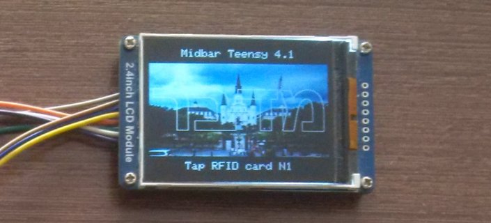

  • RFID-lockable (four RFID cards + master password to be exact) - This version of Midbar is locked with a combination of four RFID cards and a master password (Not a new feature for the Midbar project itself, but kinda new for the Teensy version of Midbar);

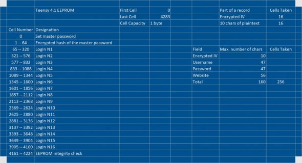

  • Combination of EEPROM and SD card storage - Enables you to store 16 login credentials in Teensy's EEPROM and allows you to store as many records on an SD card as there's available space on it (as long as you adjust the value in the "#define MAX_NUM_OF_RECS 999" line of course);
  • Ease of data backup - Allows you to effortlessly back up EEPROM data to the SD card or Serial Terminal and restore it just as easily;
  • Sophisticated encryption with integrity verification - Midbar utilizes a 3DES + AES + Blowfish + Serpent Encryption Algorithm in the cipher block chaining mode of operation combined with the HMAC-SHA256 to encrypt your data and check its integrity;
  • EEPROM integrity verification - The Midbar checks if the EEPROM is tampered with each time you unlock it;
Midbar (Teensy 4.1 Version) V2.0 can be used without the SD card. Although without the SD card, you would only have 16 slots available for your login credentials, you can still use it as a data encryptor/decryptor and data hasher;
And let's not forget that this version of Midbar allows you to encrypt an arbitrary string with a length of up to 10 000 characters using the 3DES + AES + Blowfish + Serpent Encryption Algorithm in the cipher block chaining mode of operation combined with the HMAC-SHA256 without any problems.

Cool - Keyboard added!
Updated my github copy but never built it yet, not sure how large it is? But the remainder of the program flash could be a LittleFS drive that might hold more data than the EEPROM? And of course the T_4.1 can add a good sized QSPI flash that LittleFS can present as a file system as well.
Still reading the Instructable - but notice the Adafruit ILI9341display library still in use. Not that this is graphics intense and library performance matters - it is just interesting that it was noted to not work for some reason.
Wow - 6 of the Mifare RC522 units are only $14 - and includes 6 cards and 6 keyfobs and jumper wires.
Question: Are the cards written to, or just read for ID? They keyfobs are read only. The Instructable says 'RFID Reader' - wasn't sure if anything was written to the card.
This under View for SD Card: " Note that this feature isn't available for the data stored in the EEPROM."
> EEPROM shows a View option, but not Edit in the screen shots?
Is that comment misplaced?
Interesting project and quite involved, good work. Put parts in AMZN cart - just might build it to see.
Would be nice to have a way to use alternate key(s) for one or more encryption algorithms to put in plain text and get cipher to share with a friend using the same alternate key, and get cipher text to decrypt.

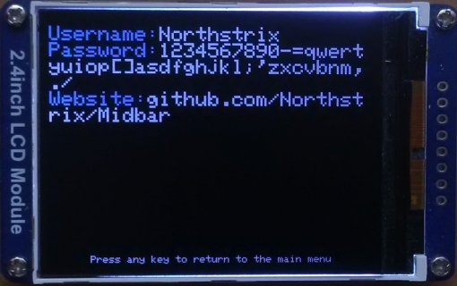

"Question: Are the cards written to, or just read for ID?" - Midbar doesn't write anything on the RFID cards, it only reads their ID.
"This under View for SD Card: " Note that this feature isn't available for the data stored in the EEPROM."
" - Let me clarify that, there's no mistake.
The edit feature is unavailable for the data stored in the EEPROM (only Add, View, Delete, Type, and of course rewrite the record in the slot).
The view feature works for all data regardless of where it's stored.

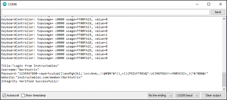

But you can't print the content of a record stored in the EEPROM to the Serial Terminal, that's why I wrote "Note that this feature isn't available for the data stored in the EEPROM." in point N7 of step N21.

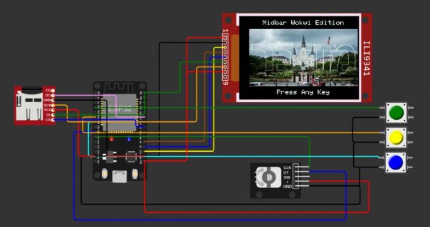

Get familiar with Midbar without assembling it
If you want to get familiar with the Midbar project without assembling it, you can play with its simulation on Wokwi (https://wokwi.com/projects/374498956604379137).
Note that the Wokwi edition of Midbar doesn't include such features as RFID-lockability, USB keyboard support, and Teensy's well-functioning random number generator.
The simulation is also slow and a bit inconvenient to work with, but still, it should give you a feeling of what the Midbar is.
