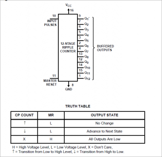

It uses the 74HC4040 (https://www.ti.com/product/CD74HC4040). This is a 12 stage counter with attached multiplexer. I.e. on each count pulse it sets one (the next) of its 12 outputs to high:
The idea is to use the outputs of the 4040 to supply the common pins of 12 encoders. The A/B/SW pins of the encoders can then be 'ored' with simple diodes. The controller would generate a count pulse which activates one of the encoders, read out the A/B/SW pins and supply the levels to the library as usual. Potentially this method should be much faster than reading out an IO Expander or using the slow analog multiplexers. The readout time should only be limited by the speed of the counter (>80MHz) and the digitalReadFast speed (~10ns).
Count and reset pulse can be shared by many counters. Each counter requires 2 (3 with switch) pins on the Teensy. So, with a T4.1 one could control some 20 counters which would be 240 encoders. CLK and Reset would probably need a buffer for that amount of counters.

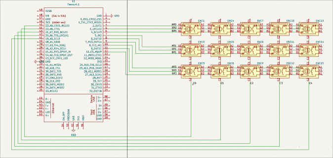

Here a first draft of a schematic supporting 24 encoders (pdf attached)
Any feedback on the schematic? Did I overlook something? Better ideas?
Ups, looks like I misinterpreted the datasheet of the 4040. It seems not to set one pin high at a time like a decade counter. Back to the drawing board...

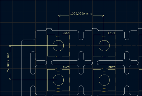

Thinking of doing a PCB, what would be a reasonable spacing between the encoders? Would it make sense to pre-cut or pre-mill the board such that one could break off an arbitrary number of encoder positions from the board to meet the needs of a project?

Yeah, mechanicals. Currectly using 19mm grid to keep the whole thing compact and portable, no knobs.
End use case is cutting loose on a Synth so with that spacing is easy to nudge a neighbor and mess with the flow. Migrating from dev to use-case will be looking at maybe 35mm grid with knobs.
I like the snap up board idea. A user can get up and running quickly. Couple of thoughts:-
Reasonably large pads, hole size = desolder with minimal damage. Metalwork floating in case user wants to play with cap sense.

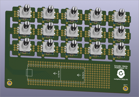

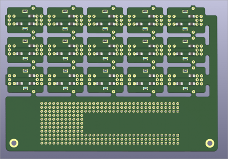

I did a draft of a Encoder Matrix Proto board. The idea is that one can start developing without the tedious wiring of a lot of encoders. After development the board can be easily cut or broken or extended to fit the mechanic design of the device. The board accepts any ARM Teensy board. With a T4.1 it should be able to support some 190 Encoders.
Here some pictures:
Maybe this is of use for someone.

Very nice principle.
Has someone tested it?
Yes, I tested it. Works nicely.
However, the board from the GitHub repo has a missing GND connection (need to fix that some time...).
If you are using a T4.x make sure to wait some time after switching rows, the board is faster than it takes the row-voltage to settle.
Just tested it, my setup needs some 200ns delay to get a stable readout.
Here the test code I used to read out the 3x5 encoder-array shown in #6.
