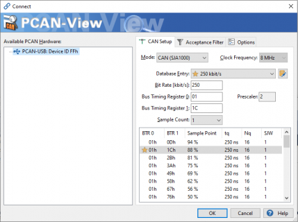

Hi, I'm working on getting my first CAN program to function, and in order to troubleshoot I've set about uploading tonton81's github example "CAN2.0_example_FIFO_with_interrupts.ino" from https://github.com/tonton81/FlexCAN...rupts/CAN2.0_example_FIFO_with_interrupts.ino to my Teensy 4.1 board.
Near as I can tell, I needed to adjust the FlexCan_T4 constructor (I'm coming from the software side of things, I'm working with an electrical engineer on this project) to use the CAN2 option because the schematic I'm working with uses pins 22/23 for TX/RX. My slightly adjusted code is below.
#include <FlexCAN_T4.h>
FlexCAN_T4<CAN2, RX_SIZE_256, TX_SIZE_16> Can2; // Pin 22 = TX, Pin 23 = RX

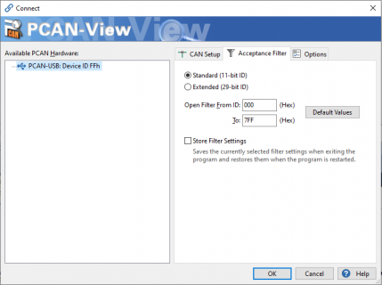

My serial output functions as I expect, with incrementing x values, however when I run PCAN-View software to see if there is activity on the CAN bus, I don't see any data being written (I am new to PCAN-View, but I think I have that configured correctly regardless). I have verified that the wiring on the CAN adapter is accurately hooked up according to the documentation. How can I see the CAN output that I need? Screenshots of my PCAN-View settings are below.
Things I've already tried include adjusting the acceptance filter in the above settings to include Extended (29-bit) IDs and uncommenting out the pinMode(6, Output) line (in tonton81's original code, this line is not commented out, I've since read elsewhere that this line is unnecessary for what I'm doing). On another note, I am suspicious that there is something that pertains to the transceiver my electrical engineer is using that I'll need to edit, though I didn't find anything that relates to transceivers in the FlexCAN_T4 library.
I'm open to adjusting anything about my strategy, as I said I'm new to CAN buses and it is likely that, from an experienced developer's perspective, I am missing something basic. Let me know if you require more info to help and thank you for any help.
