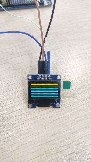

Getting horizontal stripes. Unable to updatescreen after initiation of SSD130t6 display; the buffer doesnot get loaded inside the RAM memory of displa
Rudri_Pandya
i am using a new launched microcontroller called PT32(not pic) it is similar to stm32.
using https://github.com/4ilo/ssd1306-stm32HAL.git github repository as reference and i am just printing triangle and random 6 dots on the display

void ssd1306_Fill(SSD1306_COLOR color)
uint32_t i;
for(i = 0; i < sizeof(SSD1306_Buffer); i++)
SSD1306_Buffer = (color == Black) ? 0x00 : 0xFF;
void ssd1306_UpdateScreen()
int i;
for ( i = 0; i <= 1023; i++)
ssd1306_WriteData(SSD1306_Buffer,sizeof(SSD1306_Buffer));
uint8_t ssd1306_WriteData(uint8_t buffer, uint8_t buff_size){
I2C_EE_PageWrite(0x40, 0x78,2 ); //Important to recognize byte as data
I2C_EE_PageWrite(buffer, 0x78, buff_size );
return 1;
If you want forum members to help you, you do need to post your complete code, including which SSD1306 library you used.
Also mention which Teensy, which version Arduino IDE, which exact display, etc.
Paul
Paul
i am using gcc to make binary file and then upload it to MCU.
