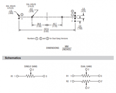

I've received a load of these slide potentiometers from here: https://www.mouser.co.uk/ProductDetail/Bourns/PTB0153-2010BPB103?qs=oyIm/3giSj5kYFpI22NVZw==
As you can see on the link, these are linear potentiometers. However, when I read them with the Teensy's ADC I get what look very like audio/log values.
Can someone give me a sanity check here, as I'm really confused how this could be the case - I've checked this model on some other major suppliers website and it's also listed as linear. Is it possible that some sort of wiring issue could cause some sort of non-linearality with a linear pot (I'm thinking no, or at least not without the output being essentially noise)?
