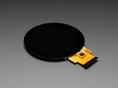

Every day it seems there are more new, high quality, high-res RGB-666 displays available. Beyond a esp32 board offered by Adafruit, there isn't much out there to make them approachable. Is there a recommended software/hardware approach that would allow me to drive them with a Teensy 4.x controlled?

I think he is referring to this..
You can emulate and RGB dot-clk interface using FlexIO shifters and timers - but I have never done it myself - I’ve only emulated 8080 on FlexIO for display purposes
But what has TTL got to do with it? This is just a 16/18 bit parallel interface as far as I can figure out.
TTL is simply in the product name, but is not relevant to the question. @Rezo is correct in his reference to one example product. Looking for good existing libraries that might embed a FlexIO implementation under a common graphics library, or a simple dedicated (affordable) hardware solution that could be placed in a PCB.
