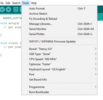

I use vscode for all my development, so I didn't have the arduino IDE installed. I had installed version 2.2 and couldn't find the menu (by the way, the Code Security page says nothing about what version to use and the Download+Install page says to install Arduino 2.0.x)
I downloaded version 1.8.19 and installed the teensy boards, but I still don't see the Teensy 4 Security menu.
That properly shows Teensy 4 selected - what version of TeensyDuino was installed? It should be the current 1.58 or perhaps the latest beta of 1.59 beta 3.
Doing "IDE /Help / About" will confirm the installed version - left corner shows IDE ver and upper right corner the TeensyDuino version.
I can't see your screen, so I'm just guessing, but maybe you tried using Boards Manager to install Teensy?
Boards Manager only works for Arduino IDE 2.x.x. If you try it with Arduino 1.8.19, you'll get an incomplete install with some stuff missing, like the Teensy 4 Security tool.
You must download and run the installer from this page:
Scroll down to "Arduino 1.8.x Software Development" to get the installer.
Arduino 1.8.19 simply didn't support enough capability for Teensy by its Boards Manager (and IDE 2.x.x still doesn't for the ability to add the Teensy 4 Security tool), so the separate installer truly is necessary to get the complete Teensy software installed in Arduino 1.8.x.
