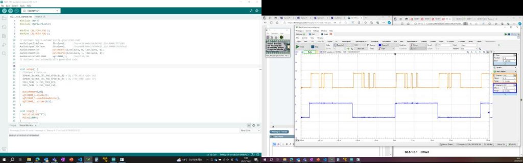

I'm using Teensy 4.1 and trying to make a TRX, which converts 2ch monoral signals into 1ch I2S stereo signal.
I set SAI1 module as RX, receiving 2ch monorals from a source,
and SAI2 module as TX, sending 1ch stereo I2S.
Here is the problem I'm stucking on,
I don't understand how to synchronize RX and TX with source's clock (figure 1).
What I understand and have already checked:
- SAI1 module can receive 2ch monoral signals (not I2S) in slave mode (synchronizing with source's clock)
- SAI2 can send 1ch stereo I2S signal in master mode (using internal CCM)
What I don't understand:
- If both RX and TX can be slave mode
- How to synchronize SAI1 and SAI2 module with source's bit clock. Using "bit clock swap"?, Connecting the pin externally?...
Thi is the configration of RX/TX registers.

In the first place, Can SAI1 module be used as both RX and TX (figure 2)?
I'm using SAI1(RX) and SAI2(TX) separetely now though...
I'd appreciate if you kindly replied.:)

Does that mean the original DATA0 and DATA1 lines (from the source) are outputting nothing for half a sync frame?
I am assuming you are not using Teensy Audio Library. This looks easy with the audio library perhaps with some audio library modifications.
Only use SAI1 because it is actually well flexible it can have up to 4 input data with 1 data output.

Thanks for the comment, Chris O.
That's true Paul's Audio Library is awesome and so easy to use.
But I think that library can be used as "master" mode for both RX and TX.
I'd like to use external clock to synchronize both RX and TX. And I assumed that I should have used "slave" mode for both.
Do you know how to do that???
Though Reference manual says one of them should be set as "async" in RCR2/TCR2 register ("i.MX RT1060 Processor Reference Manual, Rev. 3", page 2007 and 2023).
I didn't know that SAI1 module can be used for data input and data output at the same time.
So I don't have to use the SAI2 module, right???
I'll try that, THX!
