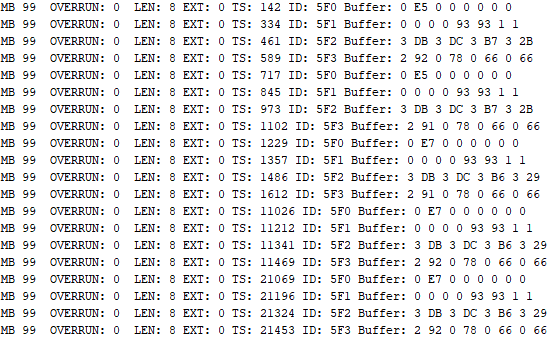

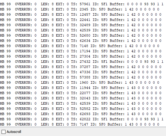

But man, I'm still having problem to understand the TX side deeply: When I lower my sending rate, things are smooth without congestion and the receiving end catches up without any backlog. But I need higher rates and I'm sure that the bus is not saturated so it has to be software runtime issues?!
I apologise but I have some more questions:
- one of my application runs fine without msg.seq=1 with 6 TX mailboxes to deliver in. But as soon as I do msg.seq=0 and I send one frame, it locks itself up for almost a whole second then the 2nd frame is sent etc... same code, same receiver... So what could lead into this situation? Shouldn't depletion be decoupled from sequencing as long as there are enough TX mailboxes?
