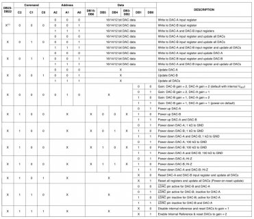

James
That snppet is not enough to see what you are doing or how you have it wired up. In particular, where in your code do you change SYNC and what are you doing with LDAC and CLR. You also seem to be sending 24 bits while the DAC8568/8168/7568 chips expect 32. Look at table 2 in the datasheet for how to enable the internal reference.
Where does that table come from? It's not in the data sheet I have. And it is missing the prefix bits and feature bits. So:

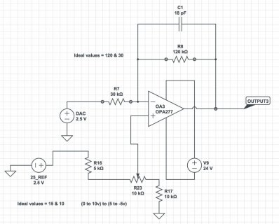

I am planning on using the OPA2171 as my op amp. Where should I stick the trim pot?
I was planning on borrowing this:

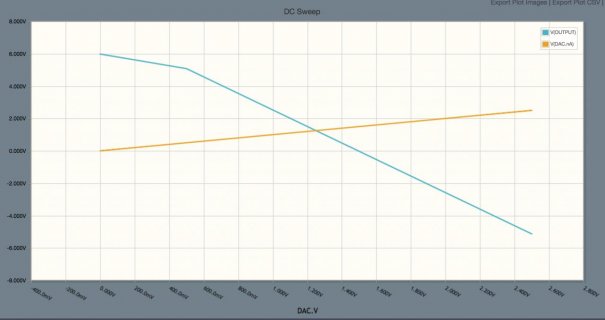

The thing I don't get is that when I put it through Circuit Labs (I wish I had discovered this ages ago — I've learnt so much in a few days from playing) I get a negative voltage.
Yes, that is an inverting op-amp configuration. The DAC output is going to the negative input. If you want a 0 to 5V range, why put Vref/2 into the positive input? Also, the gain of that circuit is -240/47 = -5.1 ?? So that would get you ±12.7V which you can't even get on Eurorack 12V rails.
You didn't say what the accuracy of your meter was, but if it gives four digit readings then an error of one count (2.501 rather than 2.500) is much more likely to be the meter than to be the DAC.
However, the general circuit (output resistor inside feedback loop, capacitor to control ringing) is about right. A gain trimmer would go in series with R27. Changing the gain to be 0.95 to 1.05 (depending on trimmer position), putting 2* Vref into the positive input, and DAC out into the negative input would get you a 0 to 5V range (but the largest digital code would give 0V and the smallest, 5V so adapt your code to suit).
Your choice of op-amp has Vos = 1.8 mV which is not ideal here (better than TL072A, though). OPA2277PA would be a better choice; Vos = 10μV.
Wait, reading about your selected op-amp I see it is rail to rail; and I see your graph has an odd kink at 5V. You are planning to run the buffer from ±12V rails, right? Because on a 5V single rail, the output swing is (V–) + 0.35 (V+) – 0.35 i.e 0.35V to 4.65V, loosing you 0.7 octaves.
i was puzzling a bit over those values, too. it seems to swing from -5v to 7.5v (ish) ( - DAC_out * 240/47 + 1.25v * (1+240/47)); i figured that had to do with the Yarns bonus modes.

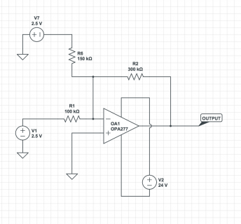

It had occurred to me that the ideal output would be -2.5v to 5v —*that way it can do 0-5v for 5 octaves but also be used as an oscillator output (-2.5 to 2.5v)
Ahhh right — now I get it... that's what that circuit is doing in the first place. Voltage divider on the VREF.
With 16-bit resolution that makes for a nice solution to be able to do oscillators as well as 1V/OCT.
So this seems like the ideal circuit — and I presume attests to what was mentioned regards adding a pot to adjust it.
Also I presume that I can take the 2.5v that goes to the op amps + from the DACs VREF output.
Adjusts from 0 to 10v all the way to +5 to -5
Useful for both unipolar and bipolar.

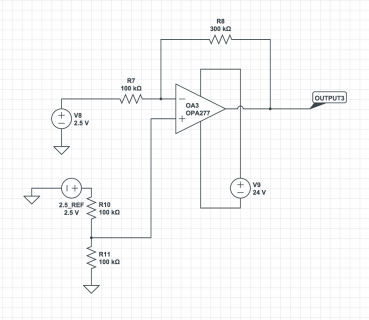

What's the guidance on choosing capacitors in such a circuit?
A decent ceramic MLCC (C0G/NP0).
Note that the circuit you have there has no output resistor at all. For outputs that are expected to short to ground during plugging and unplugging patch cords, some 50-100R output resistor (but inside the feedback loop) is advisable. The cap in the feedback loop is before the output resistor and the gain-setting resistor is after it.
Aha —*yes — also the 1k "outie" —*that features in the original schematic — I missed it off.
*EDIT* or rather I presume — the "innie" like this:
