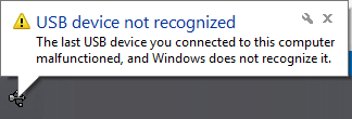

I was trying to get that set up last night but I was running into issues with Windows saying the USB device couldn't be recognized anymore.
It still seems to recognize it in that I can reflash Blink back to it and it works but a very simple app with just your code above builds but Windows doesn't like it after my Teensy 3.0 reboots. Any ideas there?
Also, do I need this bit?
pinMode(pin, INPUT);
Also, this part didn't compile...
attachInterrupt(pin, CHANGE);
I changed it to:
attachInterrupt(pin, changed, CHANGE);
void changed() {
    // TODO: Implement this. How to know which pin changed though?
For reference, this is what I see the moment I build and upload with that portConfigRegister snippet:
USB device not recognized
The last USB device you connected to this computer malfunctioned, and Windows does not recognize it.
