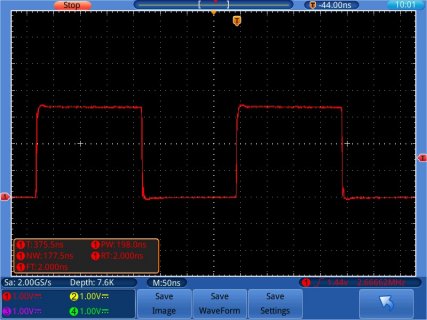

More on timings
I shoudl add, that I played around with generatung suqare waves as inicated above, Two observations, which the 'Senior' in this form probably know:
digitalreadFast() (and its counterpart) generate the equivalent Assembler statement, when called with constant parameters. so:
digitalWriteFast(10, HIGH); is equivalent to CORE_PIN10_PORTSET = CORE_PIN10_BITMASK;
but much better readable. This short loop gave the fastest square wave at 96 MHZ I could produce:
while (1) {
__asm__ volatile("DSB");
digitalWriteFast(10, LOW);
Without the __asm__ volatile("DSB"); instruction, the output would not go high the full way up. Cycle time is 73 ns (7 Clocks)

Hello defragster,
obviously you are mostly about the uniform cycles. Without the delayMicroseconds call, I'll get a 53% duty cycle and 375ns cycle time, iwth the difference between high and low cycle being 22 ns or about 2 clock cycles. The rise/fall times are 8ns vs. 7.5 ns, so it does not look like an 'analog' reason for the difference. A look into the datasheets may explain the reason. But besides that, I do not care about the duty cycle. The aspect I was looking for was a) the elapsed time between an external event and the ISR to be notified, and b) the elapsed in after which the main program is notified or some other event can be triggered. The fast loop was just a test in between, whether interrupts were detected bot not flagged. During a ISR, the main program loop would halted, and that would cause a longer negative or positive pulse.. And BTW, I have temporarily switched off the SysTick timer, which is the only interrupt source present for this test. But for the other, the hint to digitalFastWrite() was very helpful.

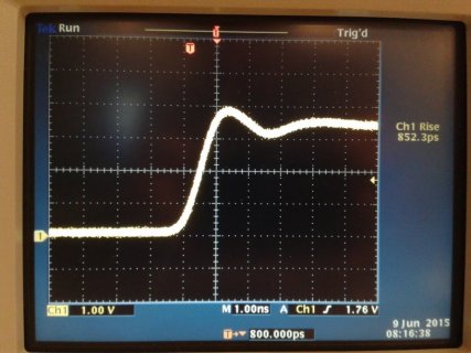

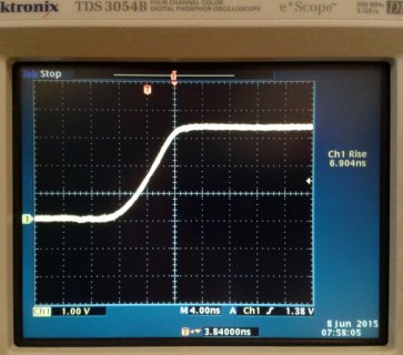

T3.1 fast slew rate: SRE=0 changes 7 ns risetime to sub-ns
Until reading this, I didn't realize the pins were configured to be slow. I went into C:\Program Files (x86)\Arduino\hardware\teensy\avr\cores\teensy3 and changed two files, core_pins.h and pins_teensy.c as a rude hack to add:
void pinModeFast(uint8_t pin, uint8_t mode); // for high drive strength (fast slew rate)
	volatile uint32_t *config;
	if (pin >= CORE_NUM_DIGITAL) return;
	config = portConfigRegister(pin);
	if (mode == OUTPUT) {
#ifdef KINETISK
		*portModeRegister(pin) = 1;
#else
		*portModeRegister(pin) |= digitalPinToBitMask(pin); // TODO: atomic
		*config = PORT_PCR_DSE | PORT_PCR_MUX(1); // SRE bit = 0 for fast slew rate
#ifdef KINETISK
		*portModeRegister(pin) = 0;
#else
		*portModeRegister(pin) &= ~digitalPinToBitMask(pin);
		if (mode == INPUT) {
			*config = PORT_PCR_MUX(1);
			*config = PORT_PCR_MUX(1) | PORT_PCR_PE | PORT_PCR_PS; // pullup
and tried this code:
const int LED1 = 0;  // output pin
  pinModeFast(LED1, OUTPUT); // high slew rate setting
  digitalWriteFast(LED1, HIGH);
  delayMicroseconds(10);
  digitalWriteFast(LED1, LOW);
Previously, when using the normal pinMode() call I got 7 ns risetime. With the high slew rate enabled I get sub-nanosecond risetimes, maybe around 0.85 ns but my 500 MHz scope/probe is not accurate at those levels. At any rate, it is quite a difference.
