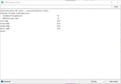

First, try running File > Examples > SD > listfiles, just to check that your SD card really is working and has the BMP file. Not much point digging into the details if the problem is as "simple" as the SD card not detected or not having the file.
Then, a few questions. Which Teensy are you using? Which version of Arduino & Teensyduino do you have installed? (click Help > About to check) Can you share the BMP file, so I or anyone else here could try to reproduce the problem?
Hi Paul and thank you for your feedback.
"listfiles" is running as expected with no failures.

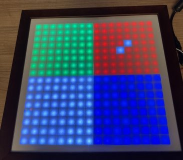

hi, so easiest way to get the colours sorts is to load a bmp that has three sections, one each of R,G and B, so that you can focus in on things. The priority would be to set the set the LEDs call "WS2811_whatever" to the description on what you bought, and then set the defines to that order. then test your RGB blocks image, and reorder the helper function.
Another way is to run the colour wipe test routine for #define RED 0x0000ff, but move the ff value to the location of R that the seller states is the order of R and G and B. if leds are RGB, then try 0xff0000
Hi Morton & thank you so much for your inputs!
I have created a template with all needed colors (plus indicator 2 white squares for rotation control)
After calibration the output looks like this:
Looks okay!!

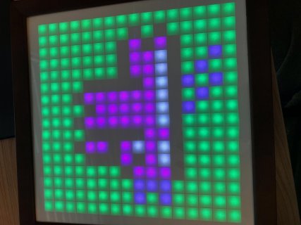

But then i open up a normal bmp for example this one:
First: rotated 90 degrees counterclockwise and looks like this :rolleyes: ;)
colors are completely messed
So how the hell is that happening?

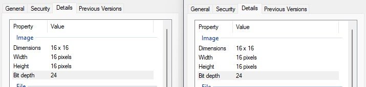

that is odd. The four colour test BMP file comes out correct, but the next BMP file doesn't. Both files were formatted to the same BMP type, 24bit?
Yes they are the same (i have recreated both the same way).

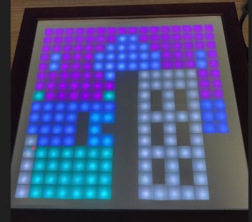

And this is a new try with a Bird:
Results in:
what strikes me immediately, the image is mirrored vertically... Could it be related to this?

confusing, and i am really not sure why this is happening. It certainly looks like for the non test image (bird) the line leds.setPixel(ledLocation, Color(ArrayR[ledCount], ArrayG[ledCount], ArrayB[ledCount]));
should have the colour values in a different order. In your image of the leds, red image comes out as blue, and blue comes out as green. might be worth a quick swap test like this:
leds.setPixel(ledLocation, Color(ArrayG[ledCount], ArrayB[ledCount], ArrayR[ledCount]));
for the rotation of the pixels, you could use an array to hold the reference pixel location, and reference that. so instead of using

Okay now its getting funny!
The "Bird" worked with the quick swap of the array.
But for all the other pictures it was wrong again ;) (tested 2 different ones)
I now use my initial code for this picture (without swaping or something) with this bmp:
With the Result:
correct colloring....
For the "Bird" i need to use the color swap from your answer above to get it shown correctly! ("leds.setPixel(ledLocation, Color(ArrayG[ledCount], ArrayB[ledCount], ArrayR[ledCount]));" )
