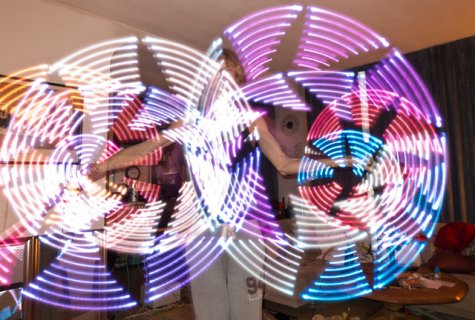

You can't really see it in the video, but I am doing some very basic POV using some simple update algorithm. The result:
In psuedo code, I am doing:
10 retrieve color value based on gyro or accelero reading
20 "colorWipe" from ends of staff to middle with that color, with a few ms in between each pixel.
30 wait 5ms
40 "colorWipe" from ends of staff to middle with no color (lights off), with a few ms in between pixels.
"colorWipe" is a function that updates the pixels one by one in order. You can tell it to wipe from the middle to the ends, from the ends to the middle, or from one end to the other.
An alternative to the above is to use the other colorWipe modes, so instead of getting a star shape POV "cutout" like above, you get a star shape formed by the LEDs, instead, if you colorWipe from the middle to the outside. I now have 8 pixels on each side of the staff. Each pixels is 3 LEDs that are spaced 120 degrees apart, around the staff, for maximum visibility. I would like to pack more pixels in so I've ordered a WS2811 strip with 60 LEDs per meter, instead of the 32 I have now.

I've been coding for quite some hours through the night, and finally have a reasonably decent POV output, with some characters. The result:

Excellent work!!! You've got a real knack for this.
I hope you got some sleep.... I do the same thing once I get my head into a fun project, I can't stop.
Once I get those new light strips, and the IMU, I'd love to play some with your code.

I haven't implemented any of the latest code suggestions yet, but I did make a video last night of what I have so far:
http://www.youtube.com/watch?v=ob8jcgis0LU
Basically what I'm doing is using each accelero + gyro axis to generate an 256 bit value for RGB. I'd like to reduce the "whiteness" when spinning fast, perhaps switching to HSV will do that for me.
