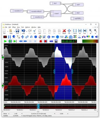

I encourage you to actually measure the latency.
Who, me? Well, I did, anyway :)
I created a simple audio engine, and physically connected i2s2 out R to i2s1 in R. Hence i2s2 out L will be the same as out R, but delayed by the overall latency of the engine. I then recorded the USB output, and the result is:
The selected area shows the in-to-out latency to be 281 samples, or about 6.4ms. So there's an additional latency of 153 samples over and above the expected 128. This is with a Teensy 4.1 and rev D audio board. I then made the in-to-out chain more complex, but ended up with the same latency, as I expected:
Here's the code I used: uncomment the line in red to revert to the simpler engine:

Did you measure it compared to USB? USB has it's own latency.. :)
Don’t think I needed to using this technique - USB-right is the reference signal, and USB-left the delayed one. I believe the OP was interested in i2s in to out delay, and I think I’ve measured that. Do show me where my logic falls down, if you think it does :D
