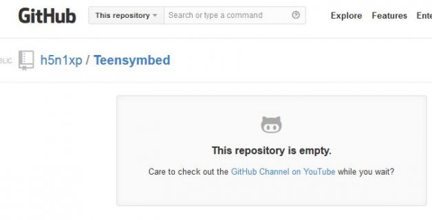

the URL has an oops...
I have an mbed.. used it for a while when it was new.
Have you studied the Teensyduino libraries of C++ classes for the K20 hardware? It's pretty extensive. Paul's put a lot of blood and sweat into these. And these enable many of the Arduino libraries for higher level functions to work.
I forgot to sync my local repo with the server, it's good now.

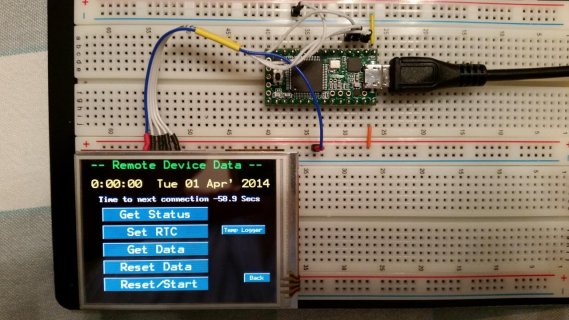

The Freescale FRDM-K20 board is now fully supported in Mbed.
I have compiled, converted to .hex and loaded a simple LED blinky program to the Teensy3.1 but it did not work.
Is this due to the bootloader code?
This board would be popular on Mbed, so may pay to iron this one out if possible before someone else markets a small board that does.
Looking a bit further, the Mbed compiles for an 8Mhz crystal, the Teensy uses a 16Mhz, perhaps this is the problem?
The bootloader code should not be the cause, I believe.
Have you tried to load your programm into a teensy 3.0 instead of a 3.1? This should be the correct target for a programm which was originally built for frdmK20.
Otherwise setting mbed for FRDMK22 may be worth a try too.
Okay, looked at this a bit closer, system_KD50D5.c file in MBED-SRC library has clock_setup defined as mode-1 using 8Mhz crystal.
Change this to mode-0 slow internal IRC (32KHz). Speed drops to 41.94MHz core and bus that will affect serial coms at higher speeds and will have poor Ticker, Timer accuracies.
This works as a test (Blinky LED set to PTC5), you will need to power cycle the Teensy to reset and run.
However the way forward would be to replace the original 16MHz crystal on the Teensy with an 8MHz crystal.
Then the Mbed code should run out of box???
I have removed earlier comments to save wasting reading time.
I now have most of the code correct and will add a link to Mbed shortly.
I will detail it more there.
