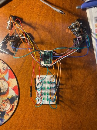

Hi guys! I'm working on a project using a Teensy to send MIDI messages when buttons are pressed and released. Additionally, the system should handle LEDs that indicate the last button pressed. While the LEDs are working correctly, I can't capture the MIDI signals on my computer using MIDI-OX or other MIDI monitoring software. I have followed the documentation to configure MIDI-OX and ensured that my code reads and discards incoming MIDI messages to avoid issues with USB buffers, but I still can't get the MIDI messages to be detected.
The main reason to do this project it's because I want to change presets on a software called Archetype: Nolly, It's a software that has all my presets.
I'm doing this project because this is the only way for me to play live

I can't capture the MIDI signals on my computer. Any ideas on what might be wrong or what else I can try to resolve this issue?
I hope someone can help me please!!
I' using a Teensy 4.0
When you #include <MIDI.h>, you are referring to the hardware MIDI ports on the Teensy, not the USB MIDI interface.
Check out this page: https://www.pjrc.com/teensy/td_midi.html.
Below is the updated code. You can use the </> button in the top-left menu to insert code like this:

Also corrected other compilation errors. Added indexing like so:

This compiles without error, don't know ofcourse if it actually works...
Perhaps this tool is helpful to you for testing whether USB MIDI data is received on your PC.

Also you're calling to the MIDI instance instead of the usbMIDI
(Paul S just posted that!)
