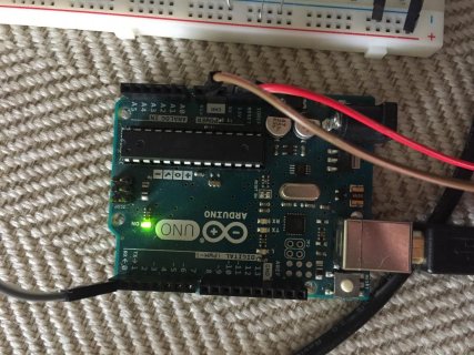

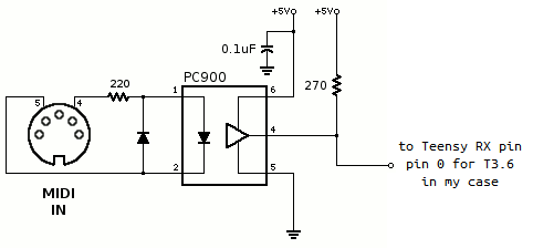

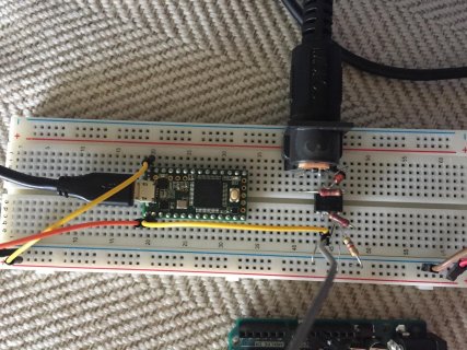

Hoping to get some help as to why i cant get MIDI to work with the teensy. I have it working with my arduino uno, when I'm using teensyduino IDE I change the usb type to MIDI. Any ideas on why it works on arduino and not teensy? thanks
