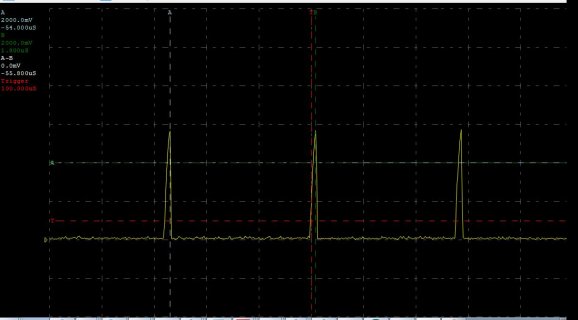

Here's a little more info. The 0.097V on the RESET_B line is due to it periodically attempting to drive high before snapping back low. This happens every 56us. I've observed this same behavior on 3 of 3 boards I looked at, so it's not anomalous. Still suspecting I need to do something with pin 2 of the MINI54 to break out of reset. RESET_B_line.JPG
This is normal when the MK20 is completely blank.
The default watchdog timeout is very short. The MK20 repeatedly starts up, but immediately hard faults. Every location is filled with an invalid instruction, causing the first instruction to fault. The default fault handler has an invalid instruction, so the CPU goes into hard fault mode, where it's completely stopped. Then, a short time later, the watchdog time reboots the chip. The reset line is bidirection open-collector, so the MK20 pulls the line low while it's resetting. Then it goes high, and the process repeats as the CPU tries to start up again.
You can check if the MINI54 is alive and working by holding PROG low. While PROG is low, the MINI54 keeps RESET low. As long as you keep holding PROG low (eg, keep pressing the button), you should see reset held low without any activity. If you see that behavior, the MINI54 is alive and working properly. If you see RESET continue to do this while PROG is low, then the MINI54 is not running.

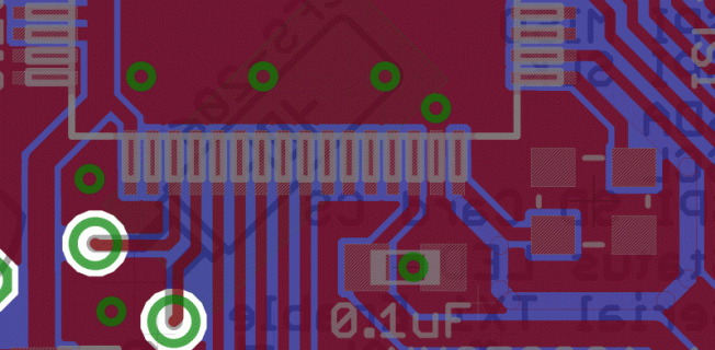

At the very least your capacitor placement for the MCUs is wrong. Power always has to run through the capacitor to the pin. The capacitor has to be close to the pin it is decoupling. Your design shows neither. Instead, you have skinny power lines running willy-nilly under the processor. Plus, the two power pins on the Mini54 also deserve a individual 0.1uF capacitor each.
The ID line does not have to be connected to pin 4 on the USB connector unless you expect to use host mode (which is not supported yet).
Your MiniTan54-MK20DX connections look OK vs. the schematic.
However, it is EXTREMELY unwise to run any power lines, digital lines, etc. under the MCU crystal. Don't do this! Instead, route them around and surround the crystal with a quiet GND area (i.e. separated from the rest of the GND plane and an unbroken GND plane beneath the top layer.
Another big no-no is your use of VIAs for the SPI lines when they don't need to be VIA'd. Simply run the lines out from the corner to bring everything to the SPI connector without using a via. Other connections on the board could easily be done on just the top layer yet use a via to pop down, etc. All you're inviting with this approach is EMI issues. Don't use VIAs unless you have to.
Why did you use a 4-layer board for this effort, as you don't seem to have used the layers as expected? Usually, one or two layers in a 4-board design are used solely as GND and power planes, respectively (or in the case of the Teensy, you may have a split GND plane). There must be a reason you did it differently...
Note how I placed the capacitor such that it decouples the power pin. I had a restrict area around the crystal to keep it happy.
