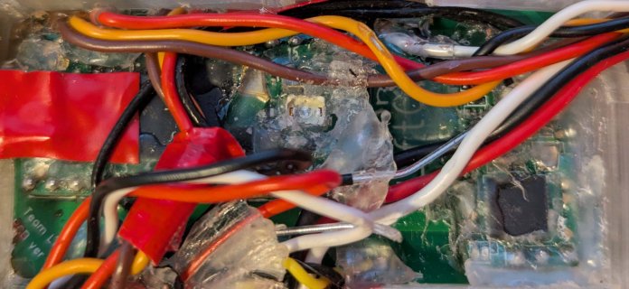

I am using the Teensy 4.0 in a combat robotics application. In the past, during matches when my Bot was hit really hard, the program button would trigger and cause my application to be disrupted... so I removed it. The white housing is still there, just the internal plastic button and small metal parts were removed.
I now have some "bad code" loaded, and the teensy loader won't load me new code. I need to press the button.
What can I do? Somewhat urgent... need to get this code done ASAP.
thanks
I got this sorted. Turns out, besides the "bad code" my USB connection to the teensy was having issues.
Future: Looking at the T_4.0 card you'll see a Program Pin hole. If that is held to GND the Teensy will enter the bootloader mode same as if the button was pushed.
