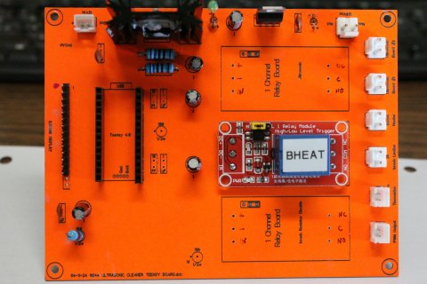

When I make my own 1 side PC Boards, I spray orange paint on the non-trace side of the board.
I the image the paint ( which is very receptive to the wavelength of the blue laser on my CNC ), with the silkscreen file, allowing a simulated silk-screen parts placement image. ( see attached )
Problem is...IPA attacks the paint, hence the ammonia cleaner.
Guess I'm going to have to find a different flux cleaner that wont dissolve the paint.
Any suggestions appreciated.

Water soluble flux looks like the solution to my problem... didn't know there was such a thing.
I'll certainly give it a try.

Hello All,
I purchased the Kester2331zx-p Water Soluble Flux Pen and it works great.
Washes off, doesn't harm the paint.
Not only is it water soluble, it cleans better than what I was using ( CS-Flux )
Win-Win.
I felt like a cave man who's discovered fire.
Thanks For the help.
