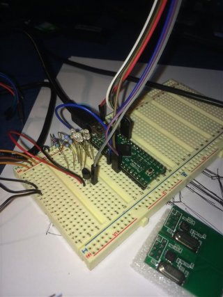

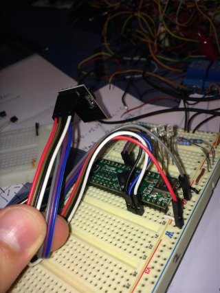

I got this module working and I wanted to share my experience so no one else has to fight with it.
I'm currently using this fork that has some extra optimizations and fixes in general:

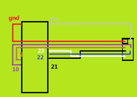

Pinout
Teensy3 -> nrf24l01
Gnd 1. GND
VCC 2. VCC
Pin 9 3. CE
Pin 10 4. CSN
Pin 13 5. SCK
Pin 11 6. MOSI
Pin 12 7. MISO
no connected 8. IRQ
Teensy++ 2.0 -> nrf24l01
Gnd 1. GND
VCC 2. VCC (*)
Pin 11 3. CE
Pin 12 4. CSN
Pin 23 7. MISO
Pin 22 6. MOSI
Pin 21 5. SCK
Pin 20 X. SS
no connected 8. IRQ
Arduino Mega -> nrf24l01
Gnd -> 1. GND
VCC -> 2. VCC (**)
48 -> 3. CE
49 -> 4. CSN
50 -> 7. MISO
51 -> 6. MOSI
52 -> 5. SCK
53 -> X. SS
no connected 8. IRQ

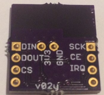

Power supply
These small modules fail if your power supply is not good enough. I have tested the following schematics on a Raspberry Pi, and two Arduino Mega (which is known to cause issues with the power supply in these modules).
Teensy++ 2.0 only:
Don't fight with voltage level conversion. Make your teensy run at 3.3V using this: http://www.pjrc.com/teensy/3volt.html
Once you do that, the 5V pin will become 3.3V, and you don't need to do anything else. Just power the nRF24L01+ from there (printed on pcb and external antennas should work out of the box).
Teensy 3.0/3.1, Raspberry pi, Arduino Mega, etc:
For the small, printed antenna, modules:
Teensy 3.0/3.1: just get your 3.3v from the teensy directly. The internal regulator is enough: https://forum.pjrc.com/threads/24343-Teensy-3-0-3-3V-pins-maximal-Current
Arduinos and RaspberryPi: Try to take 5V from Rpi or Arduino and then use an L78L33 regulator to get 3.3V. The standard 78L33 design with one .33uF and one .1uF cap works fine
For the bigger modules with external detachable antennas:
Get 5V from Teensy, RPi or Arduino, then use a bigger regulator! This module consumes up to 115 mA, and the 78L33 and Teensy internal regulator are rated at 100mA max, so none of these will work.
What I did: I live in Argentina and I couldn't find any decent 3.3v regulator in my city so I ended up using the LM317. It's a variable voltage regulator and you can change the output with two resistances. I verified the nrf24L01+ datasheet and when the input signals come from a 5V source (like the Arduino Mega, or the RPi), then you need to supply from 2.7 to 3.3v max.
I used R1=220 and R2=330 to get 3.125 volts from the regulator, and the module worked great. The LM317 can supply up to 1.5Amps and you only need 115mA (so it will run very very cool)
