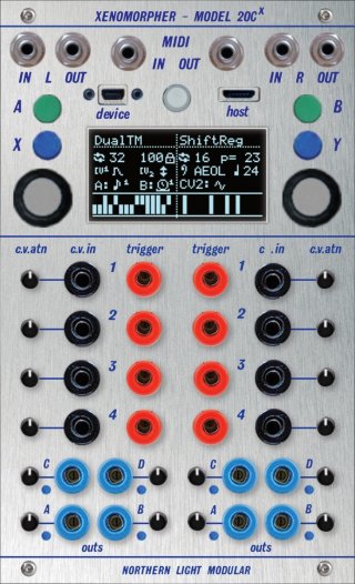

Hi Paul,
Sascha here from Northern Light Modular...
We are very much looking forward to integrate the new IC into our upcoming Polymorpher - 2OCx for the Buchla format.
Right now I am looking into implement all the input and output attenuation and level visualisation (LEDs) we had in the T3.2 model.
If you would like to provide some input regarding the hardware design , let me now :)
As for now i can share a preliminary layout which integrates the midi and usb IO found in the expanders.

Is the file for the pictured panel also available ?
