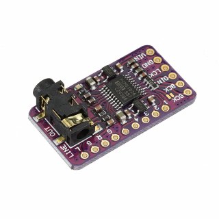

I'm trying to use the PCM5012, a cheap DAC from Aliexpress, for an audio project that's been in development for a while. The PCM5012 has been stable-ish in the past, but now I can't get any audio from the output jack. This is the same with two different modules.
In between times, the only thing I think has changed was updating from TD 1.54 to 1.55, but this may be unconnected.
My current setup is:
PCM5012 - Teensy 4.1
VIN - 3.3V
GND - GND
LCK - 20
DIN - 7
BCK - 21
SCK - 23 (although I have also tried tying SCK to GND)

What exact Aliexpress DAC board do you have?

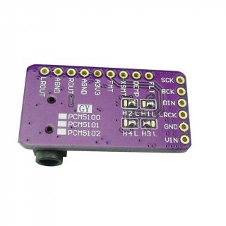

- driving the other pins on the back high or low according to JayShoe's findings a couple of years ago (https://forum.pjrc.com/threads/5306...Module-via-I2S?p=183169&viewfull=1#post183169).
(this last step should be redundant, as the PCB I have includes solder jumpers to achieve the same thing)
This appears to be fucntionally the same as what I have.

Update: in clearing down my breadboard and rewiring just the DAC to take a good photo of the setup, the DAC appears to now be stable again. (Perhaps leaving it to sleep overnight and think about its attitude helped...)
The solutions were, as you both correctly surmised, wiring SCK to GND, and using 5V power instead of 3.3V (I was misled on that one). Unsure why that setup didn't work yesterday, but I'm not going to argue with it today.

I've got a bunch of these and they work fine for me with several different microcontrollers.
Note on top of the card right by the silkscreen of SCK there is a pair of pads. Bridging them with solder connects SCK to ground.
This card has * 2 * low dropout converters, you must power the card with 5 volts.
