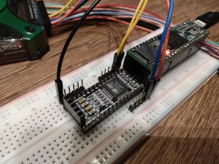

This motivated me to create a breakout board which simply gives breadboard access to the differential input and output pins of the codec. There is a version for the Teensy 3.5/6 which I've built and tested, and a version for the Teensy 4.0, which I've not yet built. I decided on a form factor which extends beyond the Teensy lengthwise (hence the chewing gum):
This allows the breakout to fit in a breadboard, and if the Teensy is mounted using stackable headers, access to all of the side Teensy pins as well. Here is the Teensy 3.6 version:

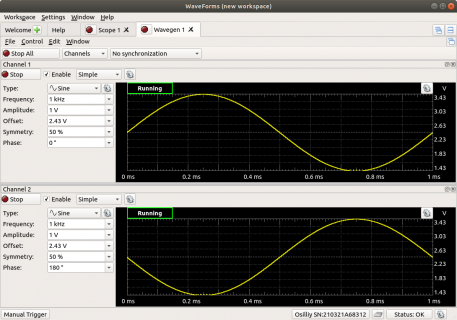

To test the inputs, I simply routed the TDM input directly to the TDM outputs (1-6) using the Audio Library GUI tool, I then used my function generator to produce a differential sine wave at 1kHz, biased to 2.43V (the value I measured at pin VQ) and applied it to the inputs.

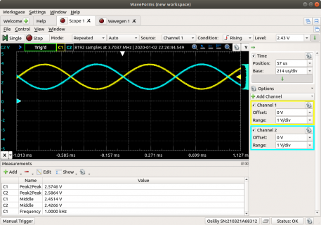

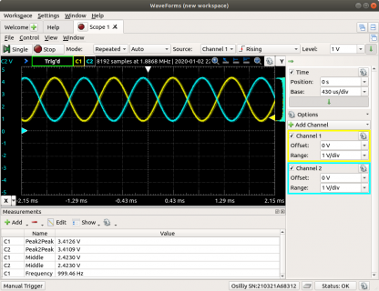

I then attached my scope to the corresponding outputs...
...and verified the sine wave was indeed being passed through from input to output.

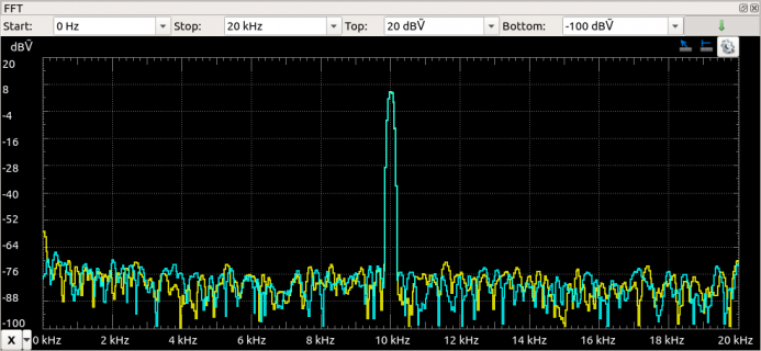

A quick spectral analysis of the passed-through signal shows a reasonable noise floor and no noticeable distortion (@10kHz).
