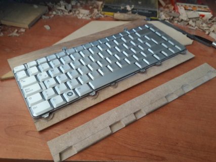

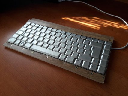

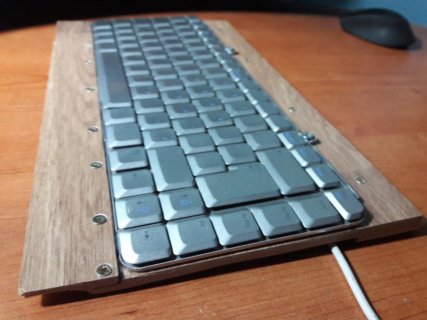

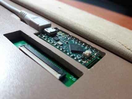

Just another laptop keyboard converted to USB. Recycled materials only :)
  • Dell Inspiron 1420 Latin-american Spanish keyboard
  • Teensy-LC (code)
  • A peace of floating floor and screws
Hope you like it!

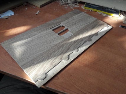

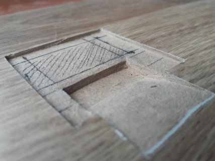

Wow, that's a really nice build. Did you use a router or milling machine to cut those slots?
I'm glad you both like it! :)
Oh no, I own very rudimentary tools, I used a couple of rusty chisels to carve the slots. I must confess that I'm not happy with the quality of the work but I was in a hurry to have a functional (and conformable) keyboard though I was surprised with the overall looking. Maybe in the future I will re-do it with proper tools and more time.
