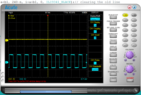

void timer0_callback (void)
adc-> adc0-> startSingleRead (A2);
digitalWrite (22,! digitalRead (22)); // for test
void adc0_isr ()
buffer_0 [buffer_0_count] = adc-> adc0-> readSingle ();
buffer_0_count ++;
if (buffer_0_count> = 128) // ned 0-128
buffer_0_count = 0;
int16_t * b = buffer_0;
int16_t * p = Queue.getBuffer ();
memcpy (p, b, 128); // is there a problem here?
Queue.playBuffer (); // or maybe here?
digitalWrite (23,! digitalRead (23)); // for test
