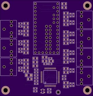

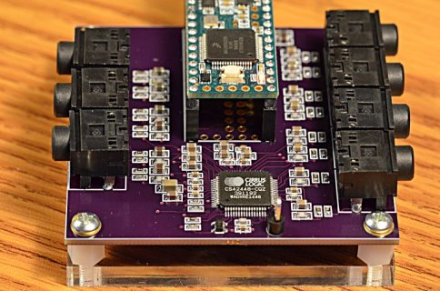

I created one just now and sent it in to OSH Park. It uses the CS42448 chip. Will send you one when they're made.
Wow great. Can you please send me a schematic, I think I must then know which pin is connected where.
There is no schematic. I just put all the parts into the layout and quickly connected them.

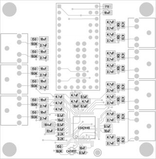

The schematic is basically the same filtering caps as shown in figure 1 on page 9 of the datasheet (including FILT+_ADC, FILT+_DAC, and VQ). The 2 analog power pins are connected to VIN (+5V) through a ferrite bead, and then it's the identical circuit from the datasheet. The 2 digital power pins connect to 3.3V, with the same caps as shown in the datasheet, and VLS & VLC connect to 3.3V.
All input pins have the circuit shown in figure 28 on page 55, and all output pins have the circuit shown in figure 31 on page 57. AIN1-, AIN2-, AIN3-, AIN4- have 4.7uF capacitors to ground. All other analog signal negative pins are left floating.
The only custom thing I did was a CAT811T reset chip which drives pin 3, and a pair of resistors (both pullup & pulldown) connect to pin 1 so the I2C address can be configured between 2 values, and that ferrite between Teensy's +5V and the filter caps for the analog power. Everything else is directly from the CS42448 datasheet.
The data connections are:
MCLK (Teensy pin 11) to MCLK (CS42448 pin 10)
BCLK (Teensy pin 9) to ADC_SCLK & DAC_SCLK (CS42448 pins 9 and 18)
LRCLK (Teensy pin 23) to ADC_LRCLK & DAC_LRCLK (CS42448 pins 5 and 19)
TX (Teensy pin 22) to DAC_SDIN1 (CS42448 pin 17)
RX (Teensy pin 13) to ADC_SDOUT1 (CS42448 pin 13)
SDA (Teensy pin 18) to SDA (CS42448 pin 64)
SCL (Teensy pin 19) to SDA (CS42448 pin 63)
These pins on the CS42448 are connected to ground: AD1/CDIN, DAC_SDIN4, DAC_SDIN3, DAC_SDIN2, AUX_SCLK, AUX_SDIN. Other unused pins are left floating.
I didn't do anything special with the ground. I tried to route the digital ground directly down the center of the PCB and the rest of the ground wires that fan out to the left and right are analog ground. They meet at a couple points near the top side of the chip. This wasn't meant to be a super high signal quality design... just something ok with the simplest single-ended passive filters for testing. Maybe someone else will make a better PCB with active filters using the full differential signals, but this quick & simple board should at least let us experiment with the software side and still get reasonably decent signals.

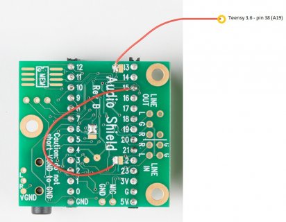

Sorry - trying to interpret the conversation you all had in January in this thread regarding how to connect two audio boards to the Teensy 3.6.
Were those updated library files you were discussing included in the later releases of teensyduino?
If so, is the only update to the quad channel output setup guide shown here https://www.sparkfun.com/news/2055 to connect the pad near pin 13 on the audio board to pin 38 on the teensy 3.6 for i2s output?
Yes, Teensyduino 1.36 has the audio lib with Teensy 3.6 quad channel support.
Yes, that's right.
Don't forget to remove the capacitors normally connected to pin 15 from both boards.
