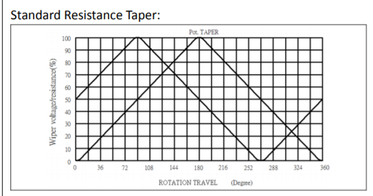

This is the behaviour of the potentiometer:

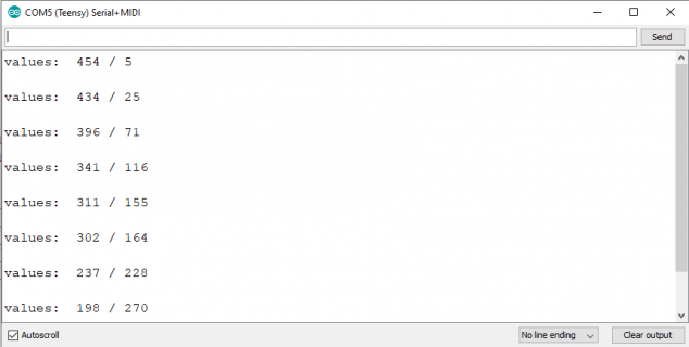

This is what I got on the serial:
This is the code so far:
int val6, val5;
Serial.begin(38400);
val6 = analogRead(6);
val5 = analogRead(5);
delay(250);
if (abs(val6 - analogRead(6)) > 10) {
Serial.print("values: ");
Serial.print(val6);
Serial.print(" / ");
Serial.println(val5);
Serial.println("");
