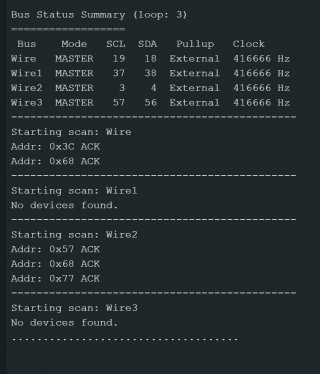

The sketch works well on Wire (i.e. Wire0) but now I'm trying to Sync to a DS3231 RTC module on Wire2, while keeping the OLED active on Wire0
I am using several I2C devices:
on Wire0 there is an SSD1306 OLED and a MPU9250 (not in use)
on Wire2 there is the DS3231 RTC with an AT24C32 EEPROM, and a BMP-180 pressure sensor (not in use yet).
The I2C_scanner sketch sees them all AOK (see attached)

This is partiallly working as the code detects the AT24C32 EEPROM on Wire2, but is not retrieving the time from the DS3231 RTC on same I2C bus.
(plus the OLED is working and I2C_scanner detects all the active devices on Wire 0 and Wire2)
