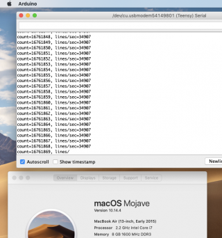

When Teensy sends data very rapidly with the lines/sec benchmark, on some Macs the serial monitor loses parts of the incoming data.
But when I run it here on my Macbook Air, I see this:
Why the data loss happens on some Macs but not others is a mystery. :(

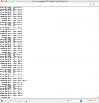

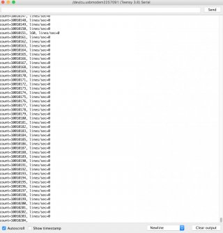

Ok this first test is Arduino 1.8.8, macOS 10.13.6, Teensduino 1.45. I'll update to latest and try again in a bit.
Old usb_serial.c (included with package):
New usb_serial.c (provided my Paul):
Both just stop printing at the point where it cuts off (10001323 in the second one). I also get "An error occurred while uploading the sketch" but teensyduino shows the new sketch uploading. This is a common problem for me when using any Teensy board I've learned to ignore it but could be related (it has been brought up in previous forum discussions on this same topic).

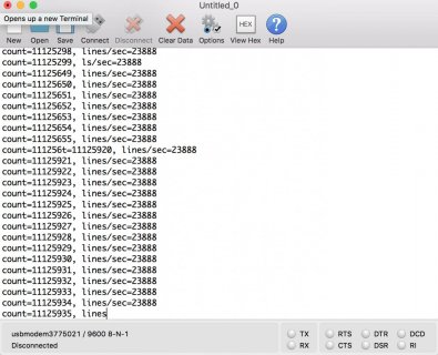

Ok, looks like the problem may be something on the Macintosh side.

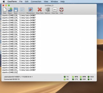

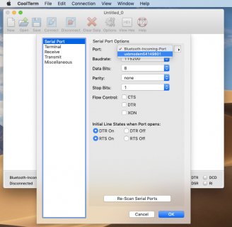

Next thing to try is whether Coolterm can receive the data without dropouts.
To select the serial port, click Connection > Options, then click the "Re-Scan Serial Ports" button at the bottom if Teensy doesn't show in the Port drop-down. The other settings don't matter. Here's a screenshot of how I tested.
Then click the "Connect" button in the toolbar. Here's how it looks on my Macbook Air.
If Coolterm can receive the data without problems, then the bug is very likely in Teensyduino serial monitor code. Or maybe in the Arduino IDE itself?

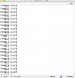

Now using a Teensy LC (left the 3.6 at home, sorry for the change but the behaviour is the same).
First upload. Actually worked fine but Arduino Serial Monitor hung after a second or so.
SIDENOTE: Just as a reminder, once in a while it works fine. AND that uploaded sketch continues to work. BUT if you re-upload the same sketch without changing anything, the missed characters bug shows up. It seems to me that it is usually the first upload that is more likely to work but I have never been able to consistently repeat it.
Next upload. Missed characters and Serial Monitor hang (i.e. serial data stops streaming).

Same upload checked in CoolTerm. Many missed characters BUT does not hang (i.e. serial data continues to stream).
These screenshots were all done with the 64-byte modified usb_serial.c. But I just switched back to the original file and ran it again and the behaviour is exactly the same.
