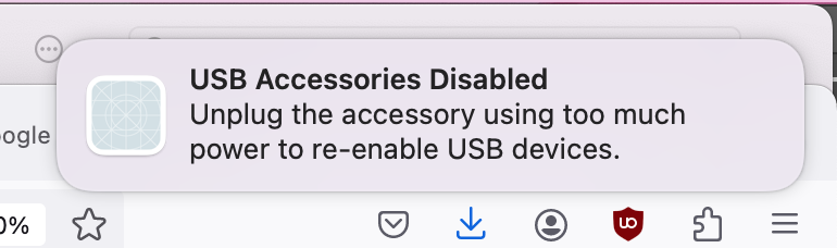

When I attach the ground to the capacitor, my macbook shows this message, and the multi meter shows no power on any pins.

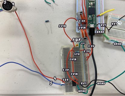

here's a photo of the wiring,

Woah! Woah! Slow down there. You're shorting Ground to 5v!!! Remember that the numbered rows on a breadboard are electrically connected. No wonder your Mac ain't liking it. Remove that ground wire next to the cap, and just put the capacitor across pin 5 and pin 8 of the 6N138. But I'd double check ALL your wiring before powering it up again.

WOOPS.
Sorry guys, I thought I was rested enough not to have the saturday stupids yesterday, but apparently it was an uphill battle.
Thanks for the replies, got it fixed up!
