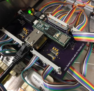

I'm on the operations staff of the Cyclotron Institute at Texas A&M University. We have two cyclotrons and a variety of ion sources, beam lines and auxiliary systems. A good deal of it is under computer control. The control system is my baby. It has a LabView front end control console and over 100 embedded controllers to handle power supplies, read vacuum, control valves, etc. etc etc. We currently use a Rabbit 3200 module for our embedded controller but we have no backup. I've been building and testing a Teensy 3.5 as a possible replacement. Our standard card has 6 serial ports, an SPI port to control relays and DACs, and a general digital I/O port ( 13 gpio bits ). The Teensy 3.5 is a good fit when combined with a Wiz850 network module. So far, there have been no serious issues while bench testing the prototype. I hope to place it in a high stress environment to test how it reacts to radiation, high energy sparking, and the heavy hand of scientists.
Pictures it is.
Looks great! I wasn't familiar with the Rabbit RCM3200 so I looked it up. Don't tell Paul how much it costs, or he might raise the price of the Teensy :)

So far, so good! It has been running for a couple of weeks with only minor teething problems.
The front end is just Labview, but anything that connects to the network can send commands and receive data

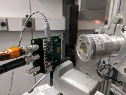

Funny I just came across this post -- we routinely use Teensy 3.2/3.6 (and soon 4) to operate devices being tested in the Texas A&M Cyclotron beamline (among several facilities we visit). They're convenient for us because they've got such a great combination of rapid development time, convenient footprint, and high performance. I'm happy to hear Cowlander is developing control routines for the facility using the same devices. Very cool!
Here's a Teensy 3.6 being used to operate a multi-Tb flash memory chip under irradiation at Texas A&M:
(photo available for public posting)
Very nice photo DukeBlue! Were you able to make any significant errors appear in the chip?
Yes, especially with highly-scaled flash (planar flash from 2014 or 3D flash) it's pretty easy to do so. In fact they won't even operate error-free outside of the beam, so a heavy ion beam can easily turn a 0 into a 1. While we are characterizing all kinds of interesting effects in the error rates of 3D flash, we're primarily trying to make sure there aren't any destructive effects on a particular device that would preclude use in a space radiation environment. The bit errors are a lesser problem.

It's a small world. Dukeblue, do you ever see any single event upset or other radiation phenomena in the Teensy?
Nope. Really wouldn't expect to with your heavy ion beam and its typical energies and ranges, and we keep the Teensy out of the beam line anyway. Some stray neutrons could maybe upset the Teensy but Ive never seen it. When we do proton testing it would be far more of an issue, but I haven't yet done one with a Teensy.

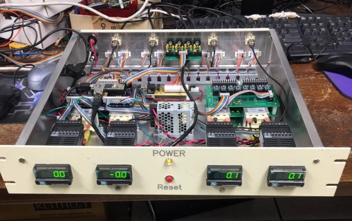

Small update since this thread got bumped. The T4.0 is my current controller for certain digital components that need radiation testing. I've been killing them off occasionally when used near, but not in, the beam line (at LBNL, not TAMU, but similar energies). I'm guessing the bootloader is getting corrupted and the parts are cheap enough that I haven't bothered to look into it too much, but it was never an issue with T3.1/3.2/3.6 which worked flawlessly near the beam.
And I've just finished an upgrade using the T4.1 ( easier layout, native Ethernet ), currently being tested. I'll need to try it in one of our hot spots.
I would be very curious in your results. I'll be at TAMU next week and might have a chance to run a Teensy in the K150 but TBD, it's low priority.

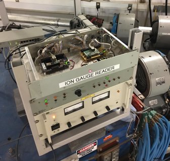

Update: The Teensy 3.5 based controllers have been retired, and the new cards based on the Teensy 4.1 are coming into service.
They never gave me any trouble in the 3.5 years they were active. The 4.1 controllers are slated to be used for all new power supply control.
