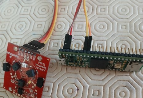

hello, i'm trying to use more AS7265X sensors with a Teensy 4.1. i'm using a TCA9548A as i2c multiplexer because the sensor have the same address. I need to use also a MPU6050 that i prefer to connect separately.
i have connected the MPU6050 to pin 19 and 18(sda scl - WIRE),and the multiplexer to pin 17 and 16(sda1 scl1- WIRE1). in this situation i couldn't start the AS7265X sensor, getting an error during the initialization. The MPU6050 worked correctly.
i tried a lot of configuration to test the sensor and the multiplexer, and i tried to connect the sensor directly to pin 18 and 19 but without result. i'm trying with a simple example but it didn't work.

Thank you for your quick response
I need a multiplexer to Connect 5 sensors with the salme address. I would like to use pins 19 and 18 for tre IMU and pins 17 e 16 for multiplexer with 5 sensors.
I tried also the minimum configuration of teensy + 1 sensor on pins 19 and 18 but it does not work.
The imu on the same pins works correctly. Thank you

i tried the scanning of the i2c connecting the sensor and i receive this response
08:09:21.030 -> Scanning...
08:09:21.031 -> I2C device found at address 0x49 !
08:09:21.031 -> done
08:09:21.031 ->
It seems a bit odd. It's finding it on the i2c bus.
Are you connecting it to Wire1?
Pins 16 and 17 are wire1
You can pass the i2c your using through the begin method
(sensor.begin(Wire1)
The connections should be WIRE: pin 18 SDA, pin 19 SDL and WIRE1: pin 17 SDA, pin 16 SCL.
Your text is indicating that you have the WIRE (0) connections the wrong way round.
Try using an I2C scanner to show attached devices.

thank you. i tried another AS7265X sensor on PINS 19-18 , and the result of the scan is
13:14:13.681 -> Scanning...
13:14:13.760 -> I2C device found at address 0x49 !
13:14:13.760 -> done
but when i try to print the data from sensor using its library the function sensor.begin() or sensor.begin(Wire) returns false. maybe should i use another function? here is my code(at the moment i have only one sensor):
