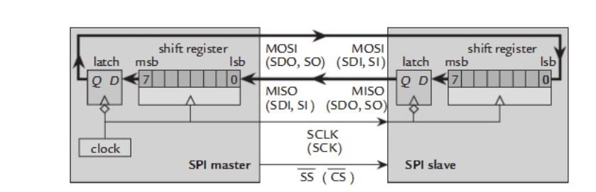

Here's a diagram showing the naming aliases and variations. It would be so nice if the industry would consistently use only the original names: MOSI/MISO and SS. Ideally, SPI and I2C would long ago have been taken as IEEE/ISO standards.
Below, note the naming variants in parentheses. DIN, DOUT aren't shown.

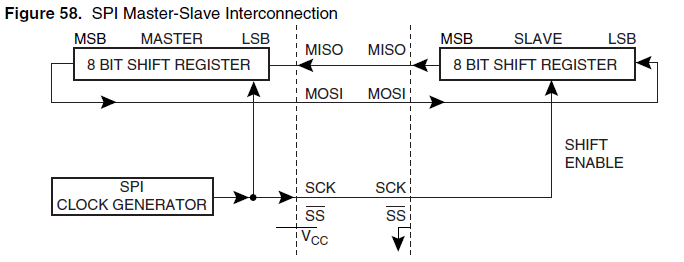

Nantonos: Yes, they will be same(Would request you to please go through the datasheet of atmega 8 about SPI protocol it has a very nice explanation and also the same is applicable to teensy because the protocol remains the same) and

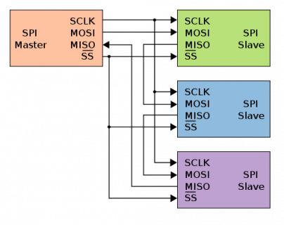

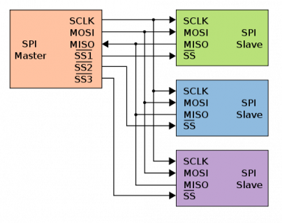

This final image from Wikipedia
shows a typical “tree” SPI, with a master and three slaves but if you look closely you will see that this is not a SPI bus but three superimposed independent SPI buses.
These busses can only be built if the devices have tri-estate pins: high, low and “high impedance” or effectively “outside the world”. When the master selects one of the multiple “chip select” line, the master is allowing only one of the SPI bus to exists and the other devices are really disconnected from the circuit (in high impedance state)
So that this configuration allows the master build in “run time” a circular SPI bus with a master and a slave and hide the other two inactive or “missing” alternate buses.
