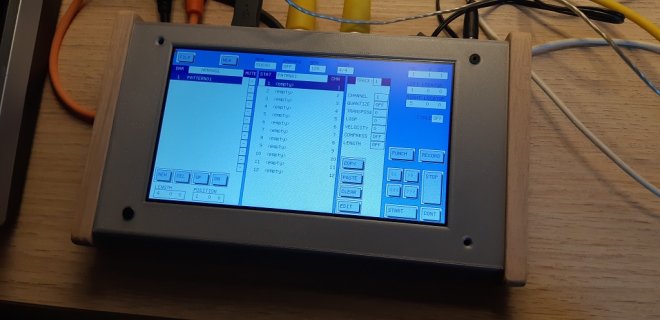

Thanks for sharing your project! It will be a valuable reference moving forward. Particularly the "PUNCH / RECORD / START / STOP" transport controls (SysEx?) displayed on your GUI are elements I'll soon be implementing in my 1) SEQUENCING section. Forgive me for pulling a reference image from your project on GitHub, but if you don't mind me asking, what do the "LEFT LOCATOR / RIGHT LOCATOR" functions do? Are each of the 3 digits various step increments represented by MIDI chunk data?
The locators are used to set start/stop for looping a pattern and the unit shown is bars/beats/16ths.
In general this UI is a vague copy of the original sequencer software from the 90's so you are probably better off making your own concept.

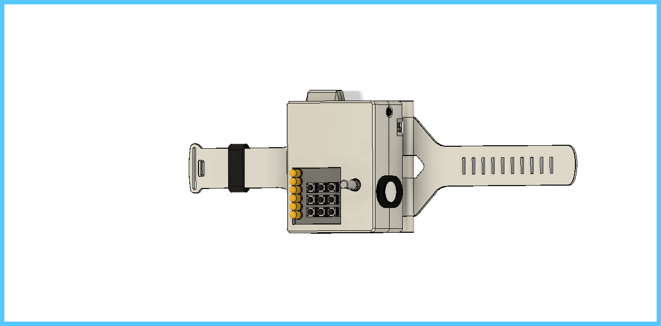

I've been busy with school and work, but just wanted to share an update since that last hazy post which was pitifully non-specific. Although I redid the enclosure in Fusion 360:
...it's still pretty large compared to the "glove" design I'm shooting for (Something more like this). To that end, I've started to build out the lipo/usb charging and SGTL5000 circuits in KiCad. I'm anticipating at least a few "gotchas" since this will be a mixed-signal board, and the second board I'll make. I'm hoping to fail quickly, and as many times as need be, in order to get this light bulb screwed in for good. Once I've decided on a 2- or 4-layer board and have those two circuits designed correctly, I plan to add the on-board speaker circuit as well. With that I'm hoping to meet the volume and quality of the audio in this demo:

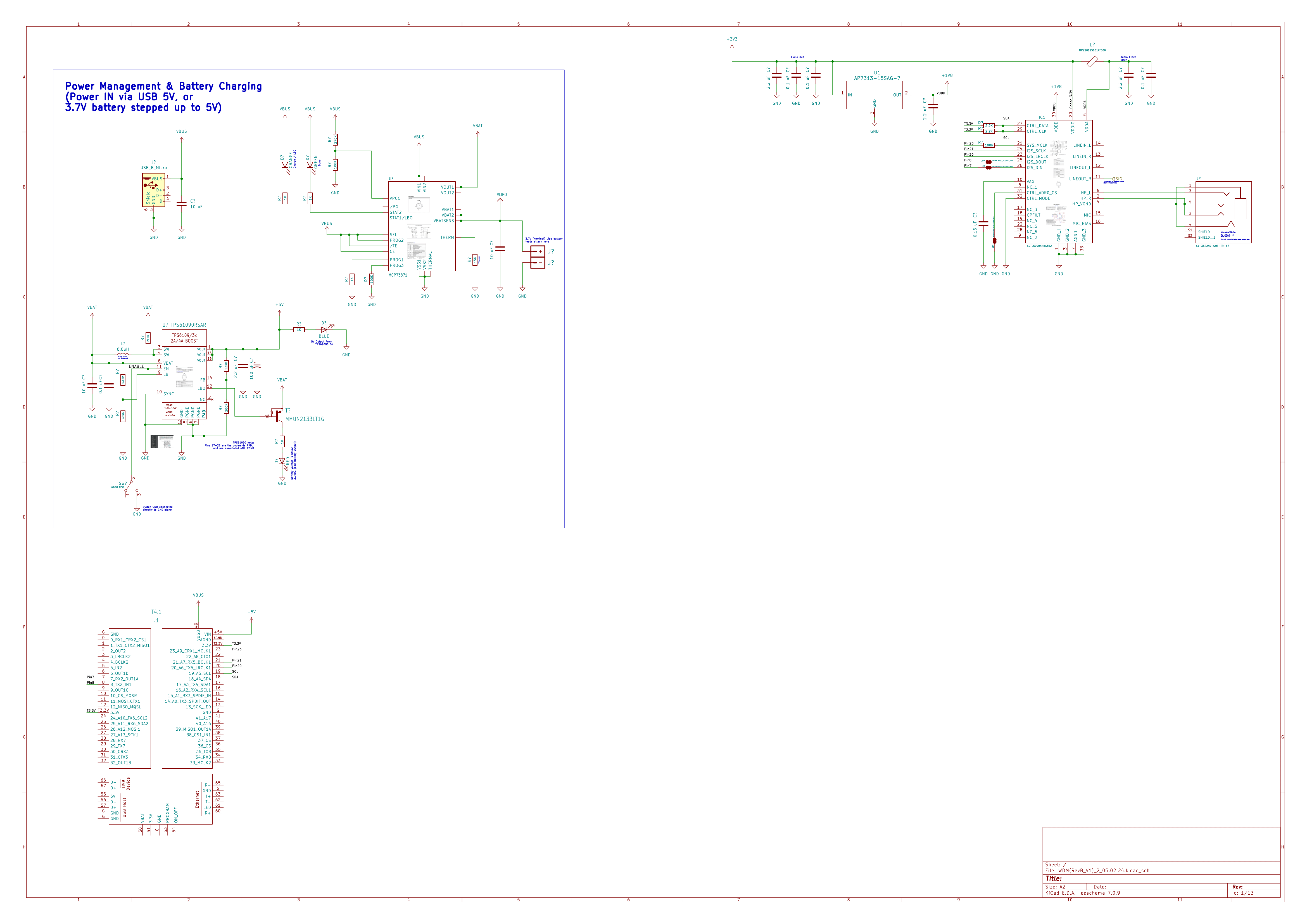

So I'm wondering - does anyone have experience designing boards that incorporate all ~3 of these circuits? Namely:
1) Battery power/charging
2) Sensors via analog pins
3) SGTL5000 + 2.5W Class-D mono audio amplifier + 1 Watt, 8 ohm speaker
If so, I'd be grateful to hear from you! Here is what I've got so far on the eeschema side:
I have a feeling this is oddly esoteric and I'm on my own as far as combining goes. Just putting the feelers out here!
It'll likely be 2-3 weeks before I've finished my first attempt with this board, at which point I'll probably post another update with what I've learned.
