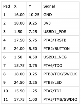

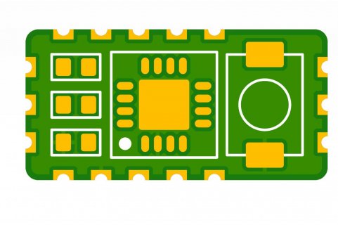

Here's the first one, a JTAG/SWD adapter. This routes the JTAG/SWD pins from a standard 0.05" header to the pogo pin array. It also has a USB port and a 5V to 3.3V regulator to power the board.
Here's the next one, a PJRC bootloader adapter. Similar to the one above, it uses USB and a regulator for power. It holds the MKL02 chip with the PJRC proprietary bootloader and has a programming button. To the Teensy loader software, this setup would look like a regular Teensy 4.0. This bootloader chip isn't available for purchase yet, and hasn't even been programmed for use with blank i.MX RT1062 chips yet anyway, so I haven't assembled one of these yet. See: https://forum.pjrc.com/threads/57132-Bootloader-Chip-For-Teensy-4-0?p=221811&viewfull=1#post221811

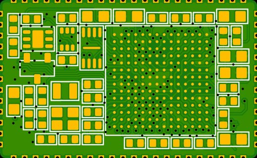

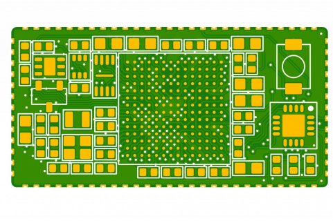

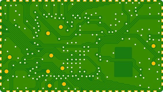

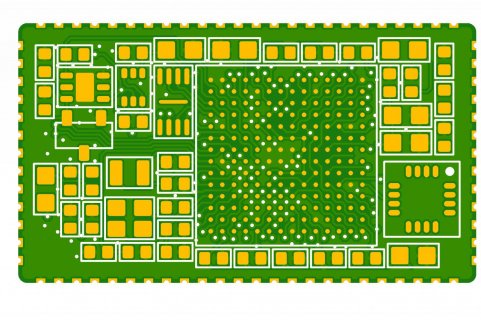

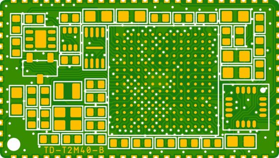

What is it?
- This is a tiny (26 x 14.5 mm) board designed to be embedded.
- Surface-mount via reflow only, pads are on the bottom.
- Should be fully compatible with Teensy 4.0 code.

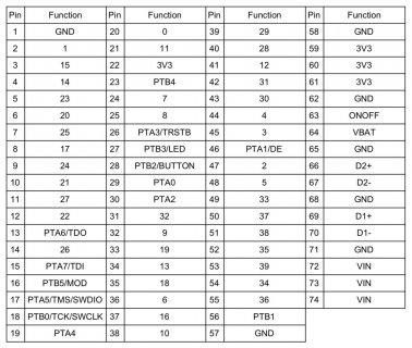

- All Teensy 4.0 pins are available.
- Does not have a bootloader chip on-board.
- Bootloader chip connections (and SWD/JTAG) are broken out for debug/flashing as 2x7 0.05" pogo pads (on top and bottom).
- Open-source design, so others can learn, modify, and benefit.
What does it look like?
This is a first prototype of the assembled board.

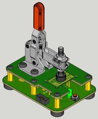

How do you program it?
The theory here is that you would do one of the following:
- Program it before assembly (PCBA manufacturer pre-programs the i.MX RT1062 chip (and the flash memory chip too?)).
- Program it after assembly using a custom pogo-pin fixture/jig.
- Program it after assembly (or final installation) using a pogo-pin programmer containing a PJRC bootloader chip (see below).
- Program it after assembly (or final installation) using a pogo-pin programmer/adapter connected to a JTAG/SWD device (see below).
- Program it after installation (in the field) using a PJRC bootloader chip (and a USB jack) installed next to it permanently.

- Big-picture: Does this project make sense, on a technical/logistical/ethical/spiritual level? Do you see a utility in these boards? Are they technically feasible, or am I making a big incorrect assumption (for example, that the MKL20 isn't necessary aside from flashing the i.MX RT1062)? Is there any market for these? Does Paul like/hate this idea? I don't exactly want to cut PJRC out of the loop here, but someone could make an argument that this is sort of doing just that (although I don't think it is exactly, but it's complicated). I haven't invested much time or money into this, so I'm pretty flexible with it.
- Small-picture: Assuming I haven't made any show-stopping assumptions, the next step is to actually get the chip initialized/programmed via JTAG or SWD. Is this even possible with OpenOCD? There's other hardware (like the LPC-Link2) and other software (like MCUXpresso) that might work and/or be required here perhaps? I have neither of these tools on-hand, at the moment.
- I could give up on JTAG/SWD for now and just wait for Paul/PJRC to release the updated MKL02 bootloader for the Teensy 4.0. Then I could assemble the MKL02 programmer and see if any of the assembled boards actually work, and if they do, I could begin testing them.
