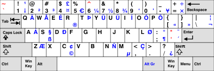

Thanks for documenting your workaround. (I would not have expected it to work, since it seems to be saying that all four numeral keys are pressed simultaneously).
An alternative approach would be to use the US International keyboard layout which, besides the more common accented Latin letters, also gives you © (Right Alt, c).
