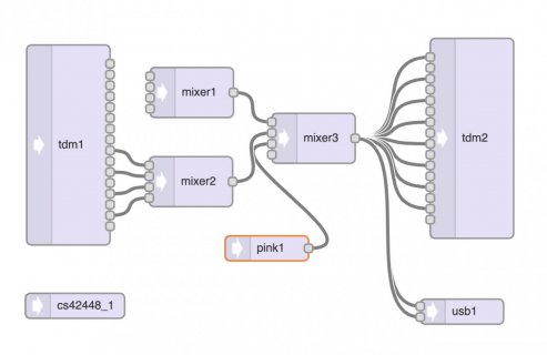

I'm having a bizarre issue with a custom audio board running a CS42448 codec.
After assembling the board, I got external audio on the TDM inputs running to USB audio just fine, then waveforms in the audio designer running to the TDM outputs as well.
I'm trying to combine them now and running into a weird issue: having all TDM input and output objects connected as in the sketch below causes a loud resonant feedback sound --- both through USB audio and TDM output. The sound stops as soon as I comment out the TDM input object (and associated patch cords).
A short audio sample recorded directly from USB audio
Strangely enough, I've narrowed down the issue to the first couple outlets of the TDM input. As soon as one of the inputs from the first even inputs of tdm1 is connected to mixer1, the feedback sound begins at a low amplitude. Connecting all four results in the full-blast sound as above.
![Screen Shot 2021-12-09 at 17.27.18.jpg Screen Shot 2021-12-09 at 17.27.18.jpg](https://forum.pjrc.com/data/attachments/23/23880-b7406f0043ea62d643614a3808f95f7c.jpg)
This passes clean noise to the outputs.

Has anyone run into this before? Any tips?
