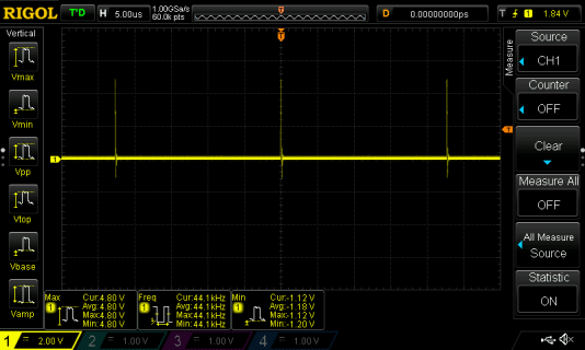

I'm trying to get the AK4619 codec working via TDM with a 4.1 but with no luck so far. Right now I'm trying to determine if it's the hardware as it's hand soldered to a breakout board, the i2c setup, or something else.
I have the device hook up as descried in the TDM object(s!) on the tool.
I'm seeing the correct clocks on 23,21, and 20 and data on 7.
More AudioMemory()? TDM objects need quite a lot, try at least 50…
Oh good point. I did that but no luck.
I did realize that there are separate connections for the TDM in and OUT in the tool.
I've removed the input object and changed the wire from 8 to 7 as that's the one sending the data.
My question about the little 44.1k pulse was answered by Paul's great video in the TDA output object as I was just looking at the input ooops.
Now with pin 7 going to the data in of the AK4619 but it's just making a quiet,15kHz sound.
Back to checking reg settings.

The clock pins are connected correctly, as far as I can tell. What clock frequncies are you seeing on each pin, or at least, are they compatible with the AK4619's requirements?
Your first post contained a screenshot from a scope but I don't see where you stated what that signal was. Which pin were you connected to and what are you expecting to see there?
I'm not very familiar with TDM/I2S pins on the Teensy so I may not have this correct! If you only have the Teensy I2S pin 7 (O1A, which I presume is the same as SDOUT1) connected to the codec SDIN1, shouldn't you actually have the codec SDOUT1 (codec pin 31) going to the Teensy SDIN pin? I'm not sure which pin that is, perhaps IN1 (pin 8)?

What sample rate (fs) are you using? With your clock setting of B00000000 the MCLK needs to be 256fs.
The teensy is sending the correct clocks. 22.6Mhz to MCLK and 11.3 to BICLK
Teensy pin 7 is transmitting the data to SDIN on the codec. I don't have anything hooked up to the SDOUT of the codec as I'm just trying to get audio out of it first.
The code above has the TDM setup and I've tried it several different ways with the same results.
Thanks for your help, though!

I could be wrong (I often am!) but if your MCLK is 22.6MHz then since the datasheet states that MCLK = 256fs, dividing 22.6MHz by 256 gives fs = 882.8125kHz!!! When setting the AK4619 clock register to B00000000, as you are doing, then fs must be between 8kHz and 48kHz - see Table 1 in the AK4619 datasheet.
Yes I am confused about the whole clock thing hah.
In this table 512fs is listed but there is no way to switch the rest of the TDM to that in table 2.
When I set it to 011 I do get sound but its mangled. The top is channel 1, bottom is 2. 1 isn't clipping as it still has that shape if the amplitudes is much lower. 2 sounds like multiple oscillators getting digitally combines in some funky way.

In your first post you mentioned you only had output from the left channels of both DACs. Is this note in the AK3619 datasheet P32, relevant to that, perhaps?
With your changed register settings, you are now operating in TDM Mode 9, not Mode 10 as in your first attempt.
What are the clock frequencies that the Teensy is outputting? For example is BICK equal to 128fs? What is the fs in your case? If it's 48kHz for example, BICK should be 5.12MHz.
